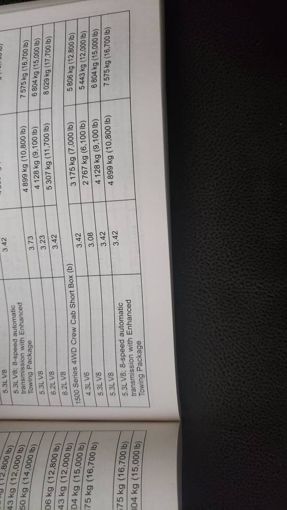

I just figured out the towing capacity on my truck after all this discussion.
I found the option codes in the glove box.
Then Google the gear ratio option codes for GM.
Mine gas the optional upgrade to the 3.42 gear ratio. Option code GU6.
Then I just had to find my truck style (crew cab, short box, engine 5.3L, 4x4, 3.42 gear ratio).
Mine comes in at a 9100lb towing capacity.

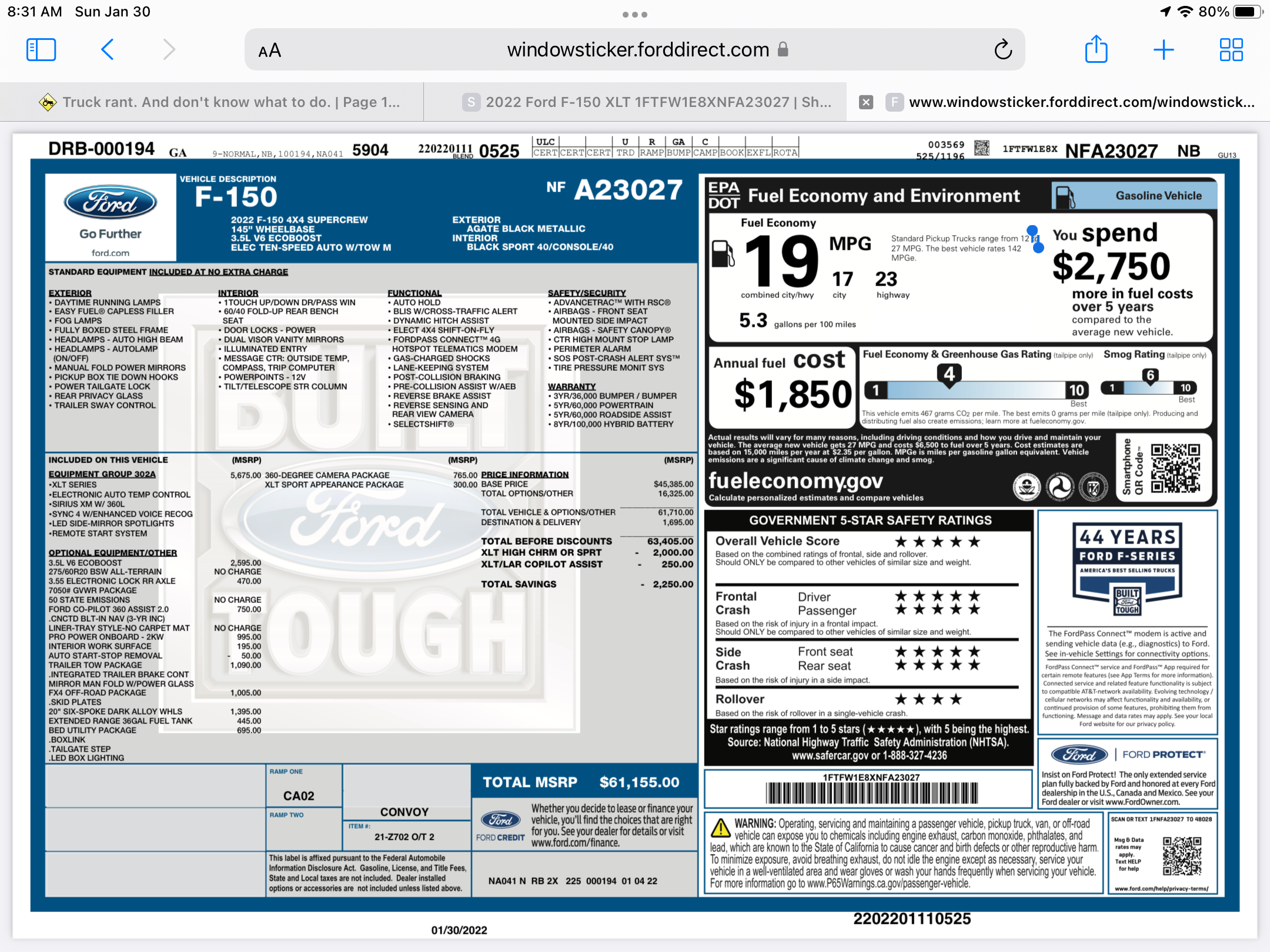

I looked at some stickers and it doesn’t seem as clear as it once was. The picture below clearly states it has the tow package. It would have the rating you want. I looked at another truck, it listed the hitch and trailer brake controller but did it have a tow package?? I know the 3.5 eco boost stopped putting external transmission coolers on, it’s built into the transmission. Are they all this way? I’d say I agree with you, it’s less clear than when I bought my truck 5 years ago.

$61,500 for a gas 1/2 ton.
Thats ridiculous! How the heck is “group 302A“ worth $5,700?
“Off road package“ (skid plates & painted gas shocks) $1,005?
But if you got the coin, good for you.
