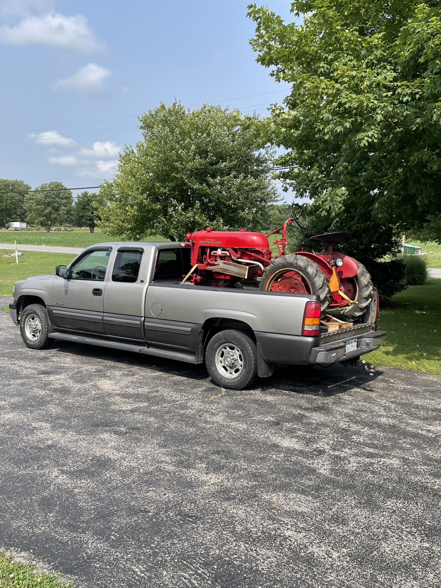

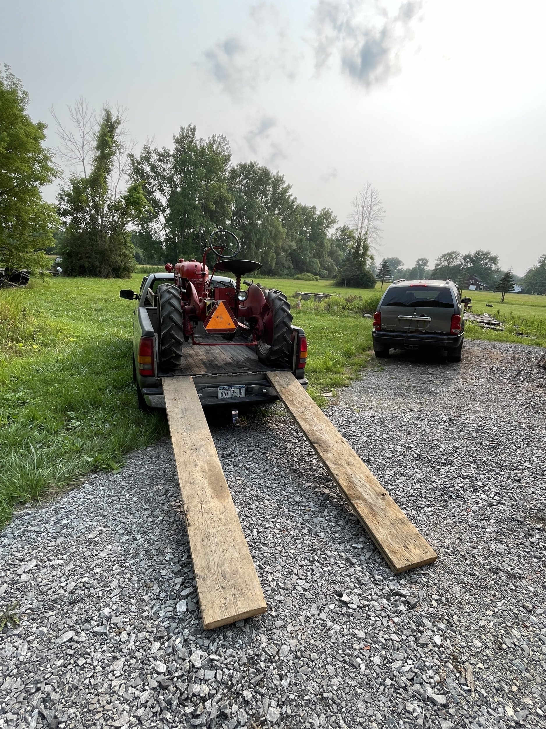

I can’t stand trailers. My 2000 3/4 ton Silverado with 8 ft box fits my tractor like a glove:
