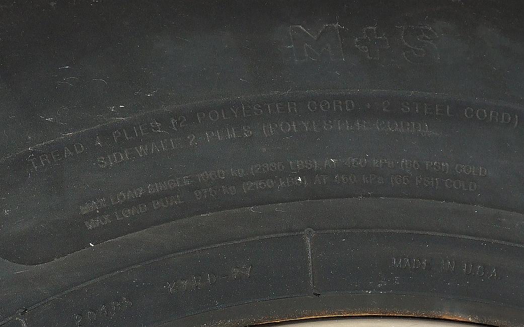

As an owner of an RV, here's my take.
Weigh the rig, front and back axle separately. Refer to an inflation chart for the size and load rating for the tires then look for the nearest load your tire is carrying, for that load a pressure will be given. Now that is the min/proper pressure for that load. Unlike car tires, LT tires give max load at min pressure.
On my MH, there are 2 separate inflation stickers found on the door jam and they don't agree. One is from the chassis maker, the other from the coach maker. Only one is correct. For my tires the max rated load can be carried @~ 5psi under the load/pressure info found on the tire sidewall. I typ carry an additional 2psi to account for small weight changes.
Look at the pic and you will see max load stated, not max pressure.
