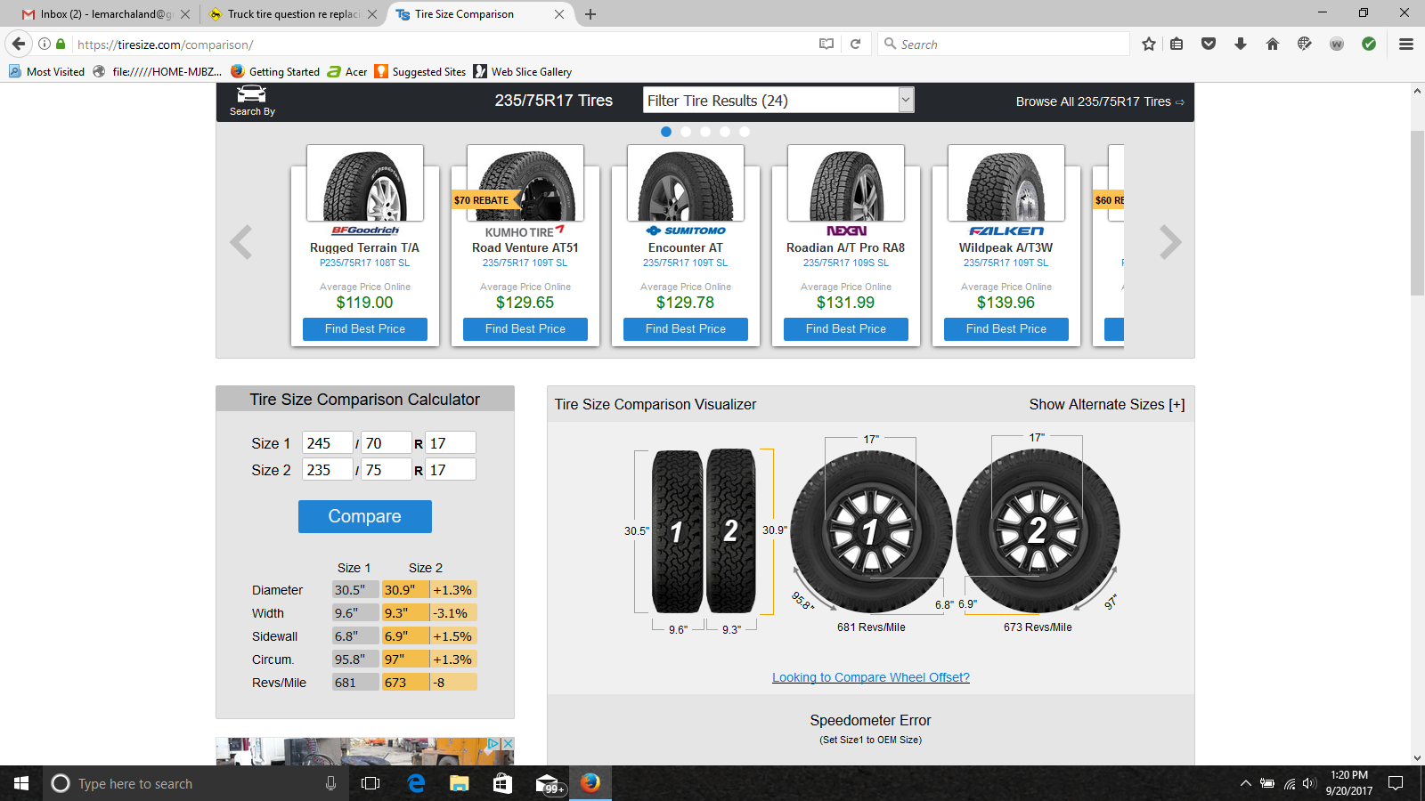

235-75-17s =
235mm divided by 25.4mm in an inch = 9.25" wide
75% aspect ratio, or the tire is 75% as high from bead to tread as it is wide. It is 9.25" wide.
9.25" wide times 0.75 aspect ratio is 6.94" bead to tread.
You have bead to tread 2 times, ground to wheel and then again top of wheel to top of tire... so 6.94" times 2, then add the rim bead diameter to get overall height.
6.94"+6.94"+17" = 30.88" tall
So it is a 30.88"x9.25"-17".
Now rinse and repeat for any metric size that you want to convert to inches... a dimension we Americans can understand!
Stock tire 30.88"x9.25"-17
235-70-17s is 29.95"x9.25"-17
245-75-17s is 31.47"x9.65"-17"
245-70-17s is 30.5"x9.65"-17" (Closest to factory)

By the way, if the need arises to compare tire sizes, you can use this nice calculator at: Tire Size Calculator - Tire & Wheel Plus Sizing
