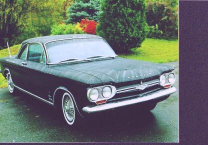

The higher the octane the less gasoline per barrel of oil....... that was true then, and true now. To improve the quality of gasoline they need to further refine it. Makes you wonder why diesel usually costs more than gasoline since it is further down the refining scale. They do have some synthetic ways of raising octane however it still is a cost factor in the end. Lead was also added to increase the octane rating of the fuel, but back in 1922 when it was first invented, they didn't have high compression engines that required the higher levels of octane. Back then, they didn't even know about engine knocking, because the engines themselves were so loud that you couldn't hear the knocking if it was present. For more in depth reading about lead and its history, click here for the web page. The author doesn't go into the lubricating properties of lead, I believe, because it isn't a factor any longer. My 1962 turbo charged Corvair didn't need lead because by then, they already had hardened valves and valve seats. It did need the highest octane rated gasoline because of the 9.5 /1 compression ration and the fact that the atomized gasoline was being compressed and pushed into the cylinders under boost....... talk about pinging if you put regular in..... it sounded like there were marbles rolling around in the engine......
