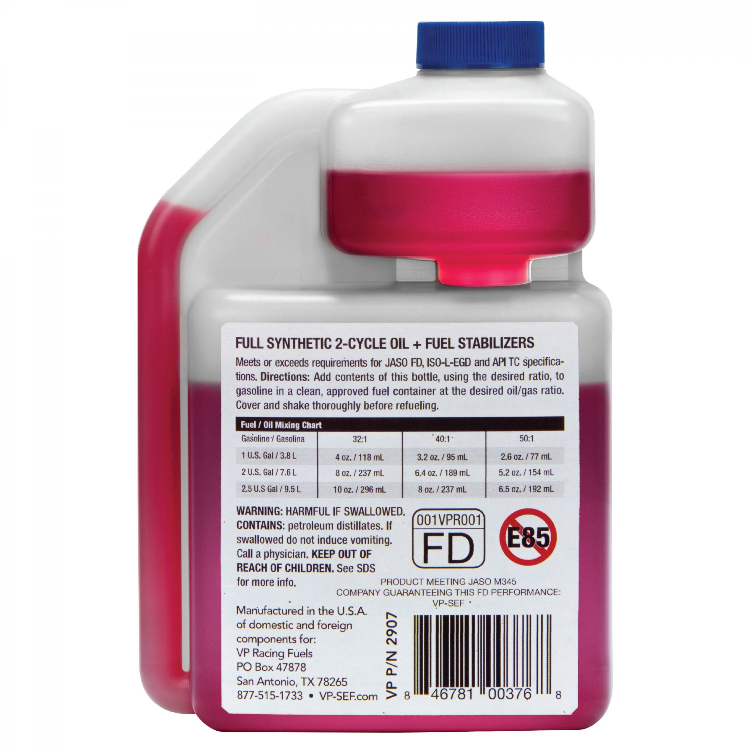

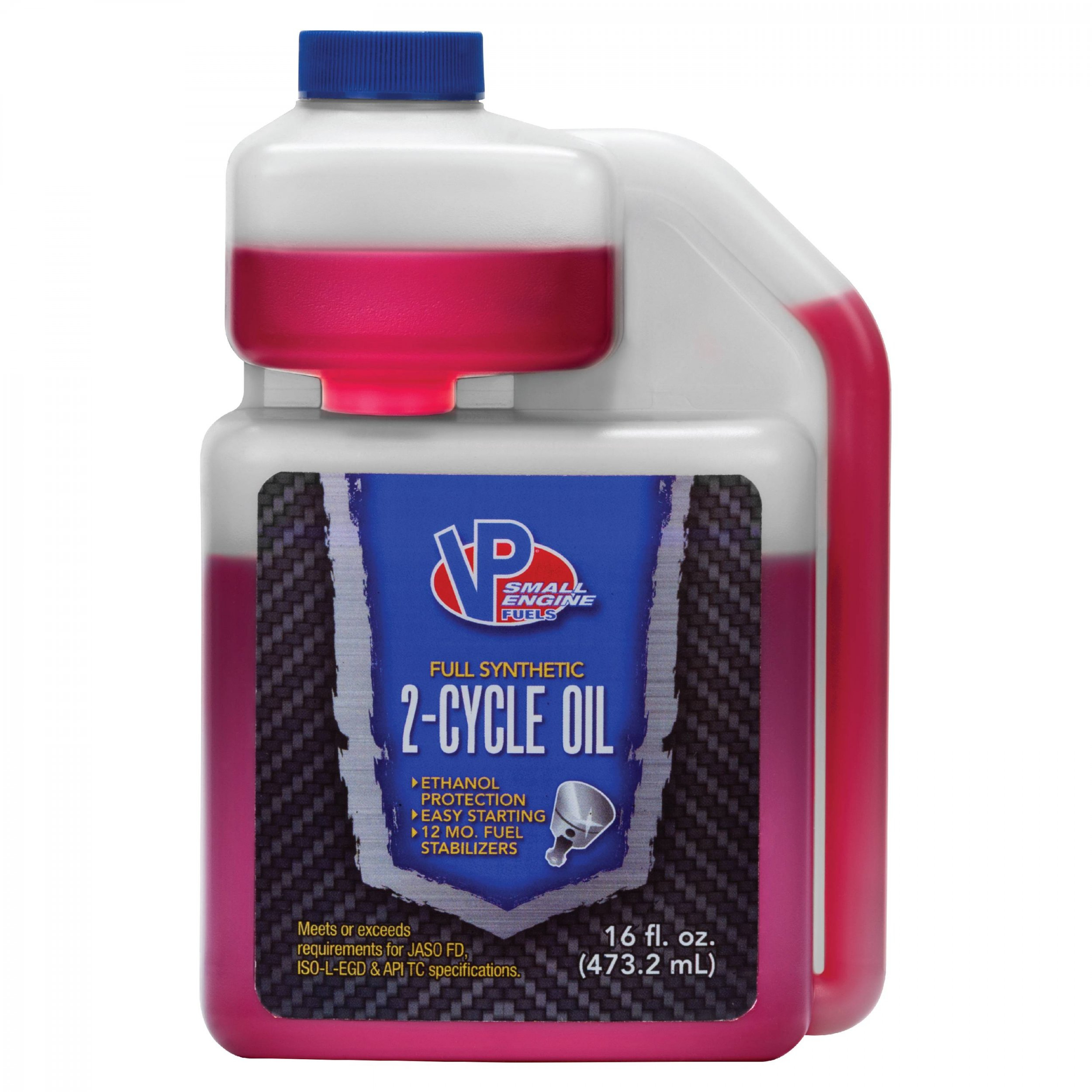

I just buy 90 Efree at pump here local at 1 buck more then e gas and mix with VP oil.
SEF premix fuel is VPracing stuff I heard.
