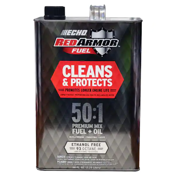

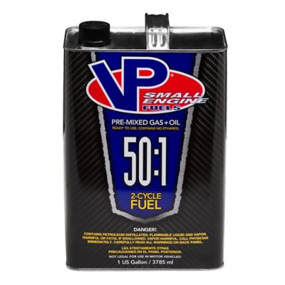

Old thread, but worth adding my 2 cents.
I strictly run VP 50:1 when i can`t find Echo Red Armor locally.
My saws love the stuff, and i`ve NEVER had any carbon issues with Red Armor 50:1, or VP 50:1.
You can get VP 50:1 (94 octane) right at tractor supply (at least ours carry's it)
You can get Red Armor 50:1 (93 octane) at most any Home Depot
I`ve tried mixing my own (non-ethanol) for years, the canned fuel is far better.
You`d have to buy your non-e gas from a dedicated pump to get a better non-e gasoline that is TRULY non-ethanol.
When you buy your non-e gas from a multi selection pump at the local gas station`s, that pump is going to give you some e gas in it until the hose and filter is cleared, and THEN, you`ll get your non-e gas coming out of the ground tanks. I`ve noticed many times buying non-e at the pump, my saws ran like sh*t, because there was some E gas mixed in it. If you don`t use a chainsaw much, stay away from the gas stations and just buy some VP or Red Armor for your occasional use.
VP & Red Armor:
Unopened - 5yr shelf life
Opened - 2 yrs shelf life
