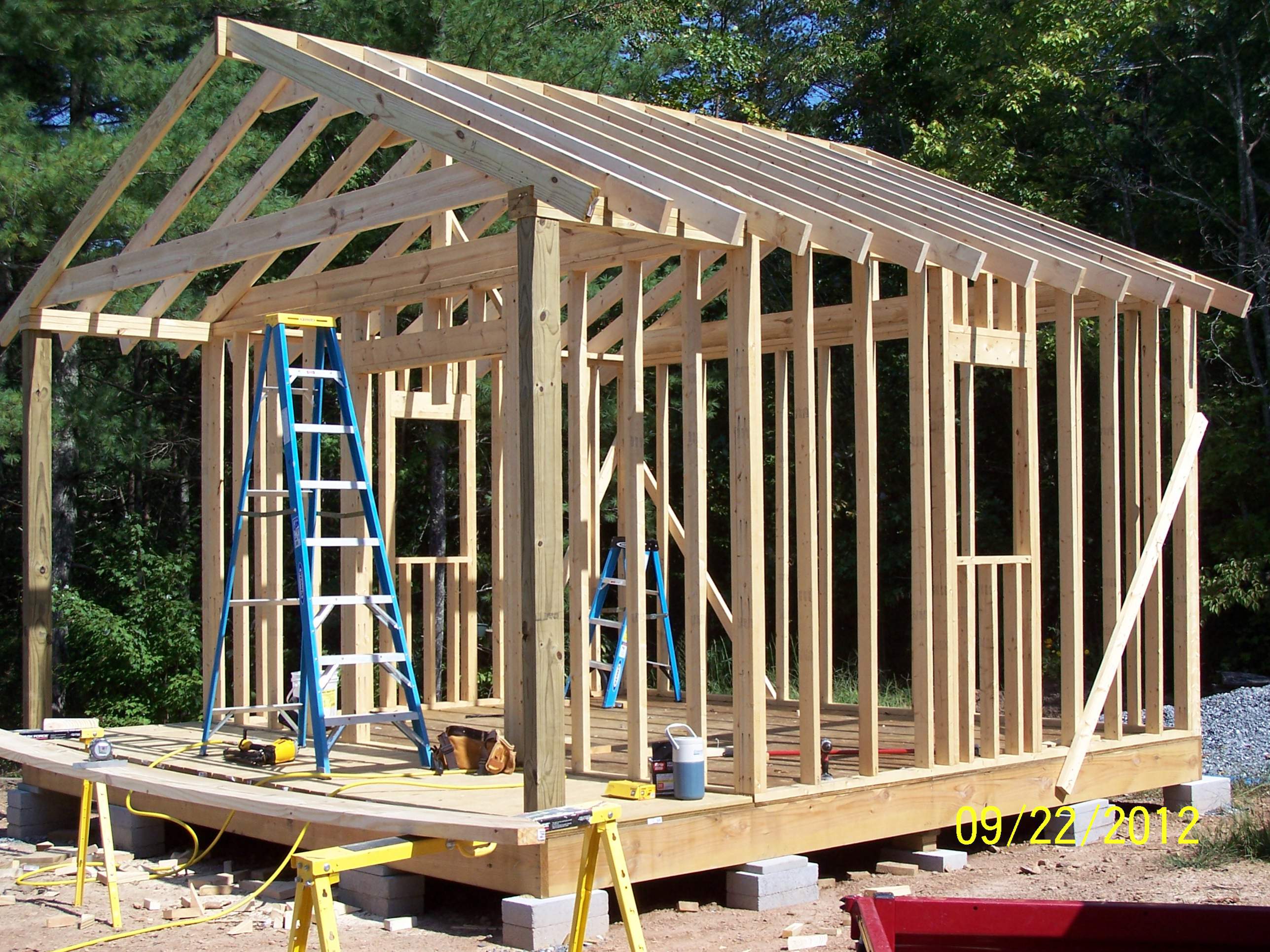

Was finally able to get some pictures this weekend. This is a slow process doing it by myself. I was abe to get some help Saturday form my son. It just proved to me that if I had someone helping from the beginning it would be about complete.
I plan to put siding on during the week and the other half of the roof this Saturday. I have more columns to put on the porch and lots of finish work. The block it is on have footings under them and I will rock those later. Will be adding large granite steps on the front and one side.
I am currently debating on shingles or metal for the roof. We are leaning towards metal, non-painted, to get the look we want.
Holding rafters up with one hand and nailing with the nail gun in the other is not easy!:(:D
And I was finally able to get the date on the camera set:thumbsup:

Looks like you're doing a great job. I always hate to give advice after the job it done, but if anyone else is doing rafters single handed, I've found it's useful to put a 1x2 or similar strip at the bottom of the ridgeboard at the right height to rest the top end of the rafter on. With this approach, I've built roofs with 18 foot long 2x6 rafters by myself (When I was younger, of course). :D

I thought about using the strip at the bottom of the ridgeboard when I was 3/4 of the way finished. I used the strip for the floor joist but why I did not think of it on the ridgeboard...:confused3::ashamed:
