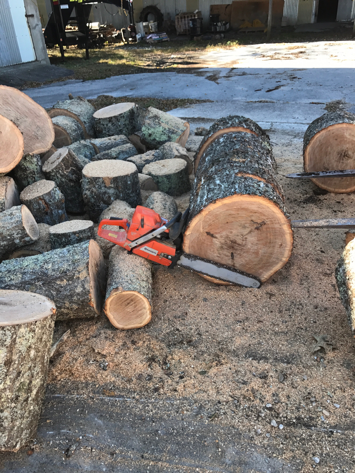

Unless I had my buddy who's not allergic to that crap I'd have left that alone. I'd probably be in the hospital after cutting that log.
That's why I had my brother cut it for me, I didn't touch it! It was standing dead in my front yard, every time the wind blew it dropped sticks and branches all over. There are 3-4 just into the brushline just like it, I'll take them out eventually but this one was the worst!

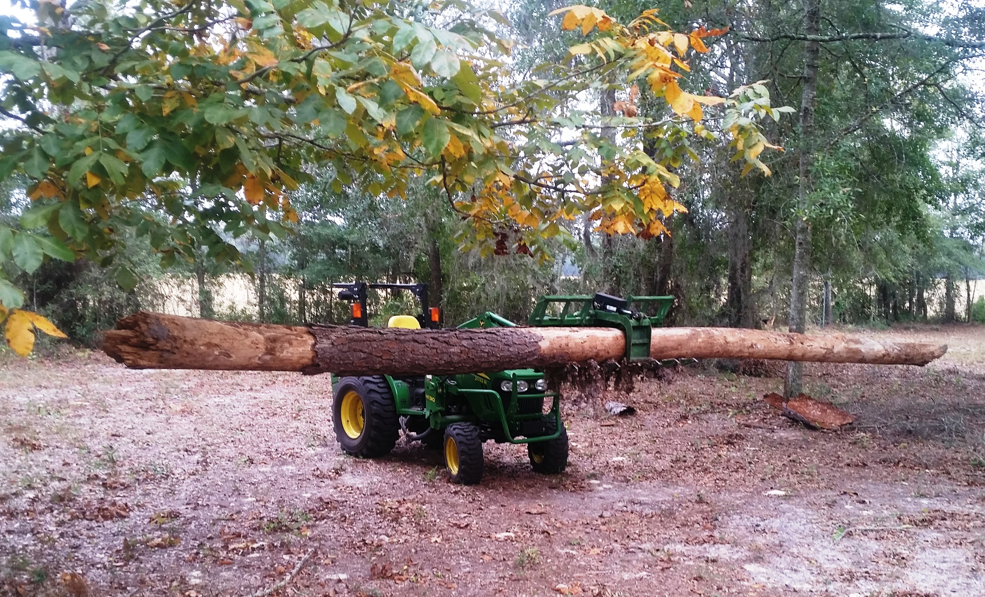

Cleaning up my neighbors yard. Ran across this dry pine tree - about 30 ft long. No problem lifting it with grapple and 32 HP.
That looks pretty big on your little tractor. It is fun doing things with your tractor that you wonder if it will do!
