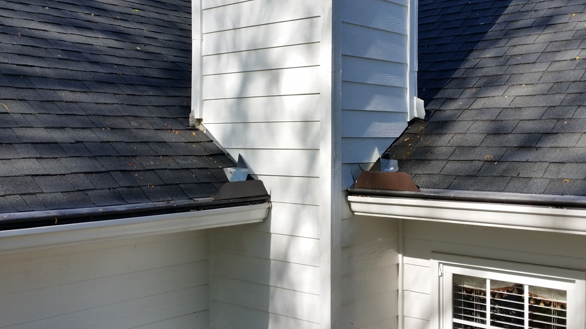

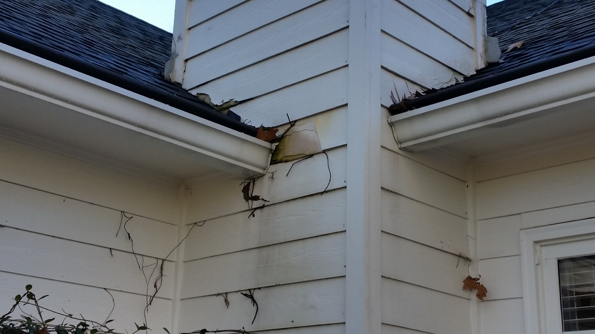

Even cement board is usually up off the shingles some (you'll see a strip of step flashing instead, but it can be painted to minimize the look), and kick-outs at the end of the step flashing where it meets the gutters are wonderful things for making sure everything goes in the gutter rather than down the wall behind the endcap. In some places (like mine) they're code. You can also add them after-the-fact with only a little trimming.

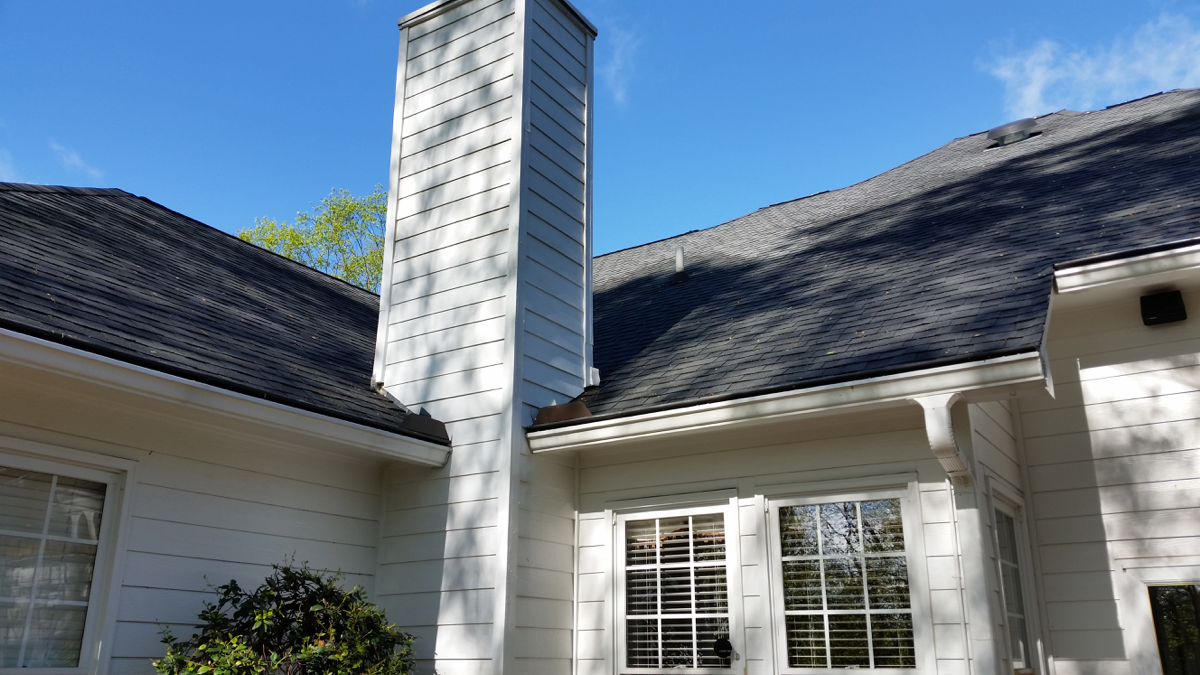

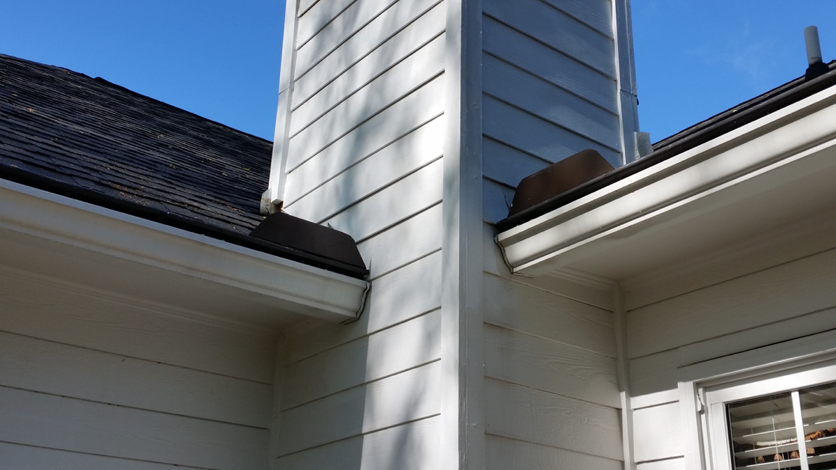

I guess I missed the angle on the left side of the chimney chase but it's not all that noticeable from the ground.
   / Trying my Hand at Hardie Lap Siding #20
That looks awesome.
That's what I don't understand...it's no more difficult to do it right, and you can't see it one way or the other from the ground, so why do we keep seeing these guys run the siding smack down onto the roof every time? The only thing I can keep coming up with is that they don't actually know what they are doing.
