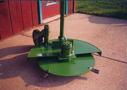

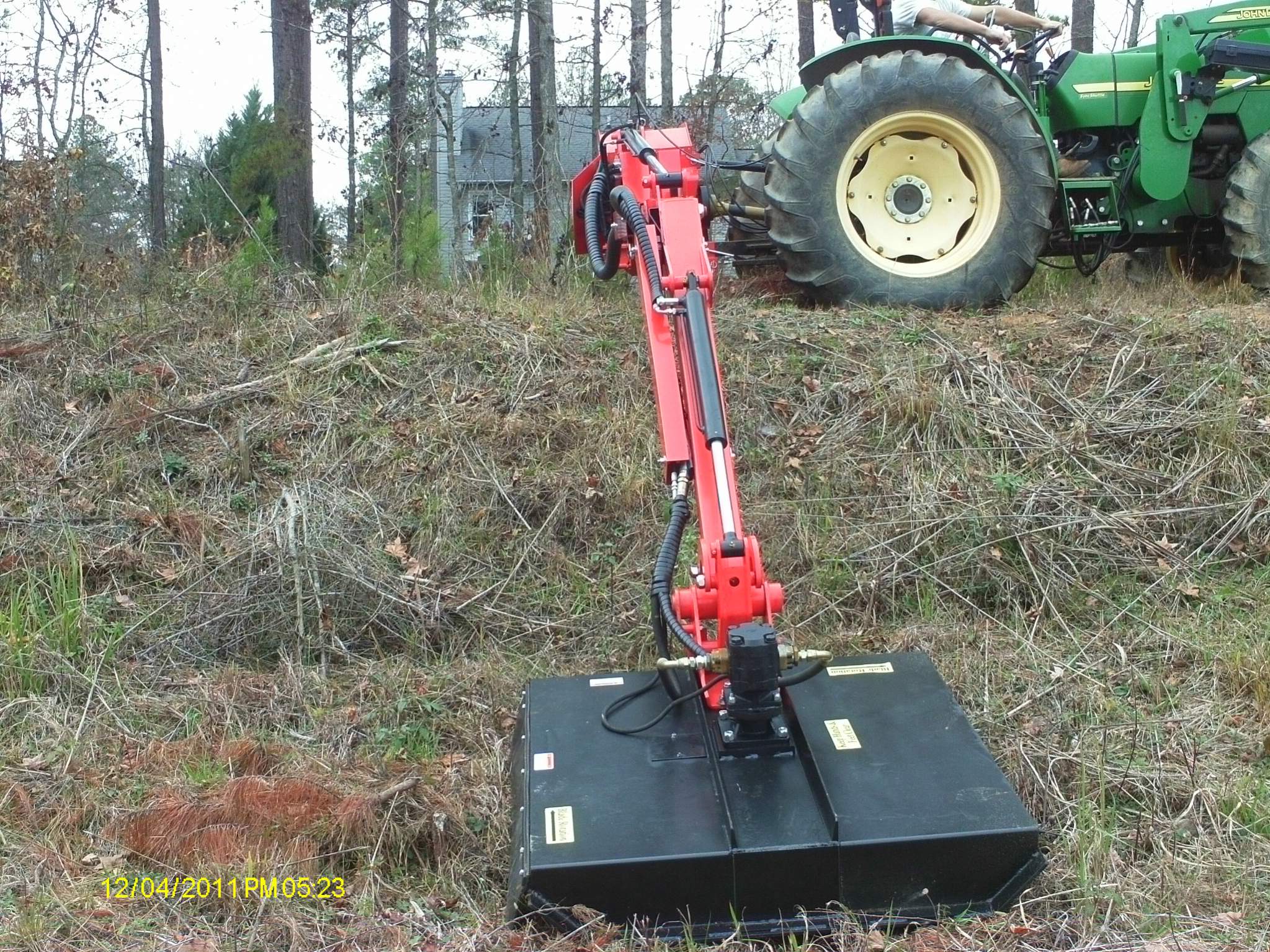

   / Trying to build a 42" Rotatary Mower #12
FlyC17s,
If you stick with the 3000 rpm, , and 11 GPM, the cu in of the hyd motor would be about .847.
The torque using .847 cu in and 3000 psi = 405 in lbs or 44 ft lbs.
Here are some pic of a hyd blade attachment. Don't know all the particulars.
