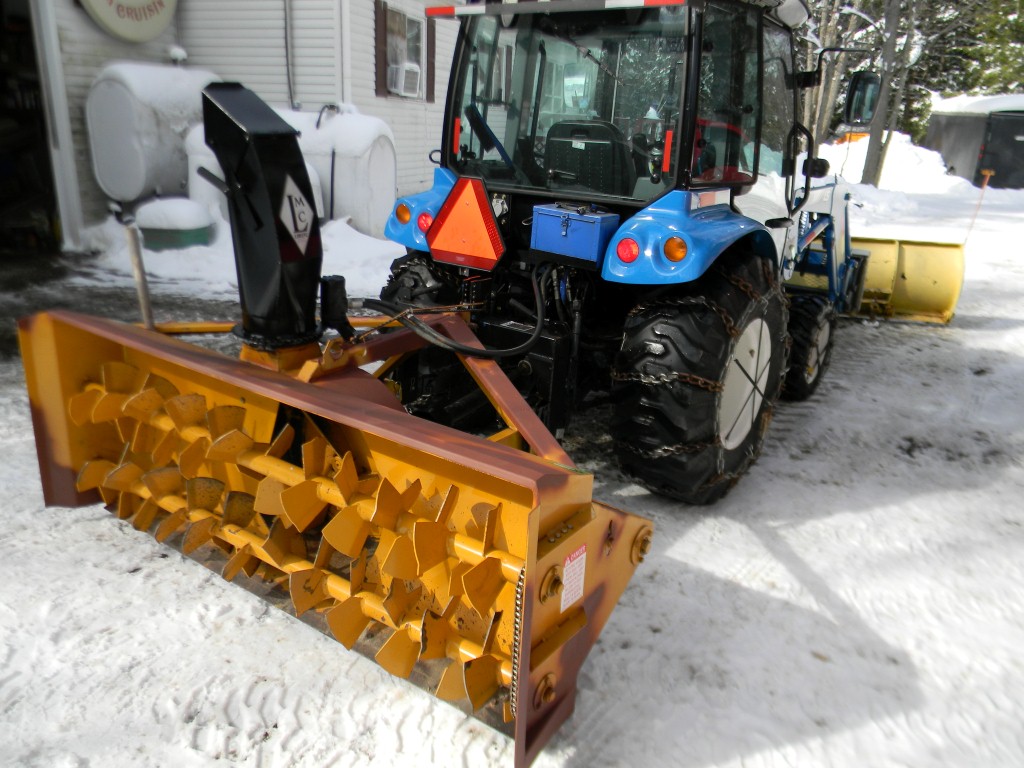

I bought a used Lorenz 84" double auger blower in near mint condition last fall. Did a service on it, cleaned masked and repainted. Mine came with the hyd. chute rotator but no deflector hyd. I found that I preset the deflector and don't need to change the setting. I think the 84" will work fine for you as well.
My tractor is 66" wide so a 72" would have worked but I couldn't find a decent used one and the 84" came along at a great price.
I did have to install flow restrictors in the chute hyd. lines to slow down how fast it turned. Also welded stops on the chute to prevent chute from blowing snow on the cab.

Nice find. I'll keep looking.
