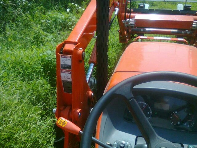

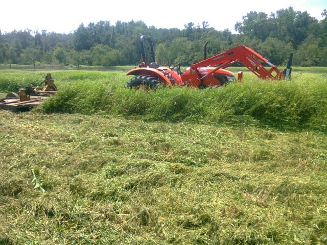

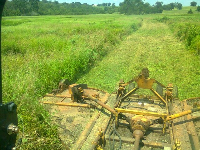

mowing bottum.JPGmowing bottum 4.JPGmowing bottum1.JPG thats 46 horses 3low 2/3mph
