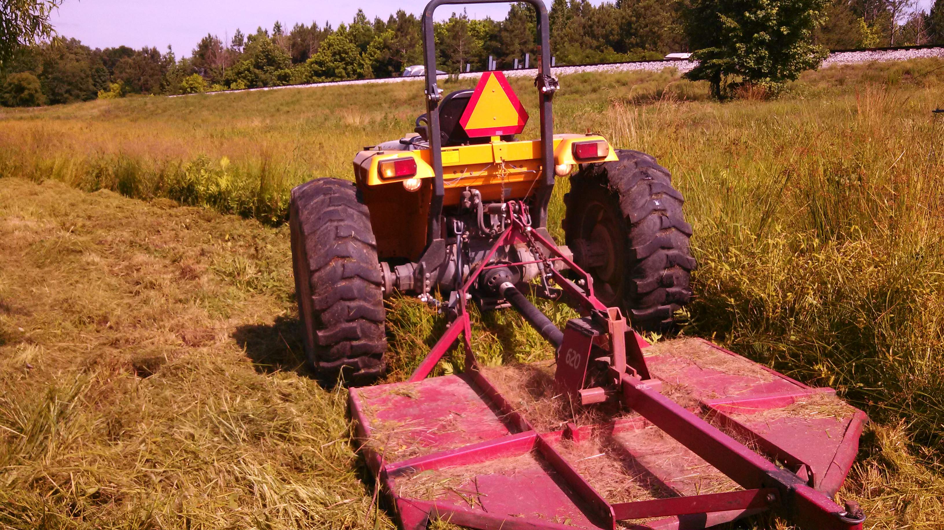

this tractor has 6" wheel spacers for the last 4 years. with the spacers its 7 foot wide.
