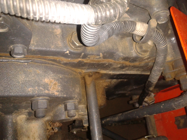

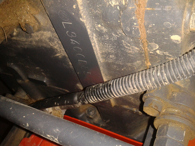

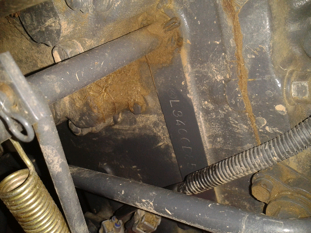

Ok I finally found it on mine, it's on the right side of the transmission case under the front edge of the seat. Stamped into a vertical flat machined surface, next to a horizontal control shaft that goes into the right side of the case. Sorry about the picture quality, it's an awful spot to get into. The first and third pic are rotated 90 degrees, lettering is horizontal.
Mine is an L3400DT (gear transmission).
If you still can't find it, you may have to remove the sheet metal cover under the front of the seat. The model number is first, then the serial.
