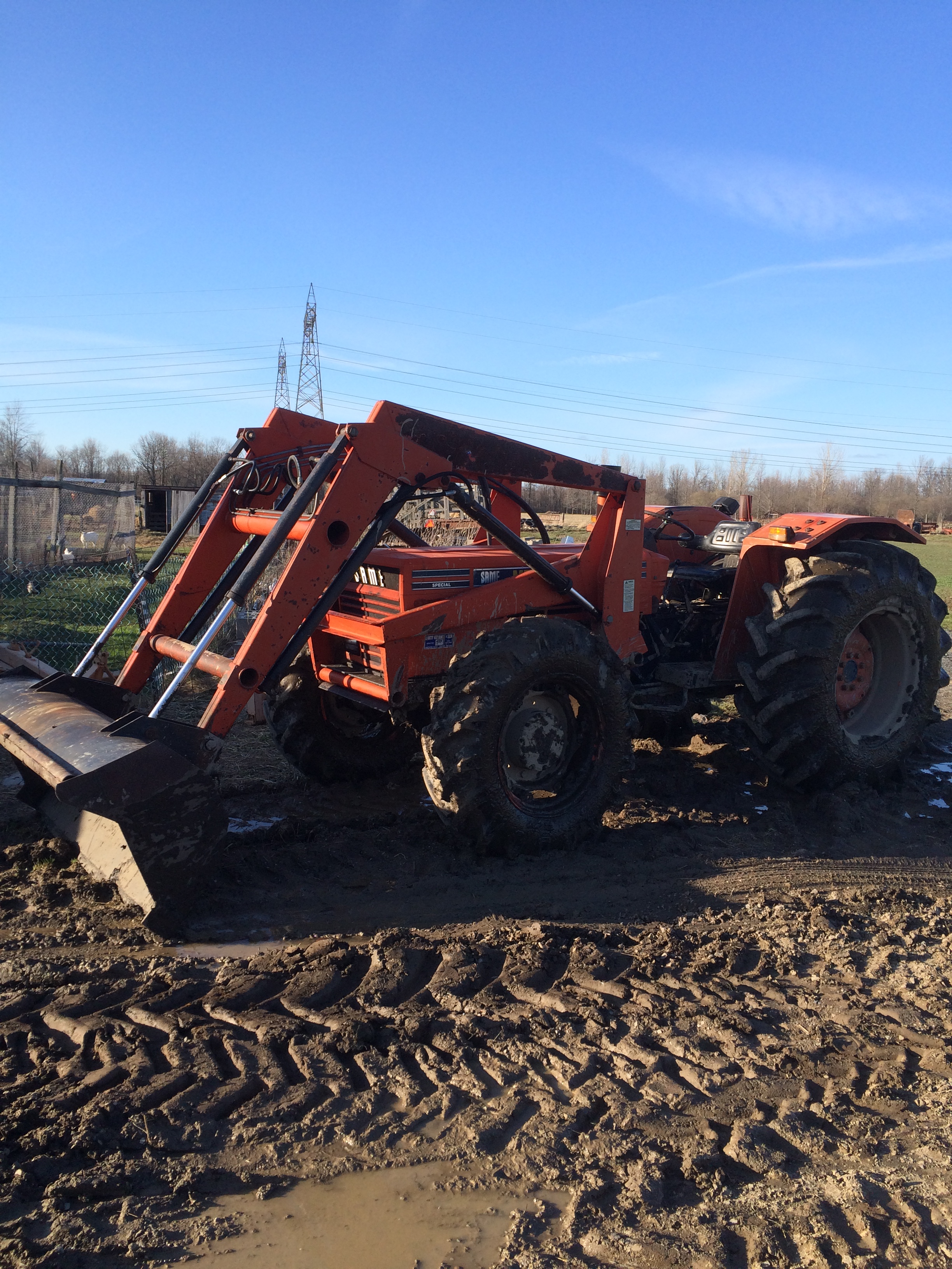

Just my quick 2 cents on this since even I am new here. It took me 3 years to find the right tractor at the right price. There are plenty of options out there for under 10k, you just need to look hard and check local auctions. The advice I was given from a much older gentlemen was to get the biggest you will need that will run all your equipment and then scale down from there as time and money free up. If you live in an area with any mud, 4wd is huge. Specially with working in woods, and then you would be set for snowy weather as well.
I bought my SAME Mercury 75 for $7500 at a farm auction last spring and for a tractor that is about 36 years old, it runs great and sips fuel. Fuel was another thing to keep an eye on for the budget spender. I was always told to stay away from gas and diesels bigger than 4 cylinder, but I didn't need anything bigger than 75hp. If you are able to do any of the mechanical work on your own and have the time and equip to do that, I would buy an old used 4wd tractor with loader.
IMG_0062.JPG This is my $7500 auction special, ready to work with no repairs right from the start.
