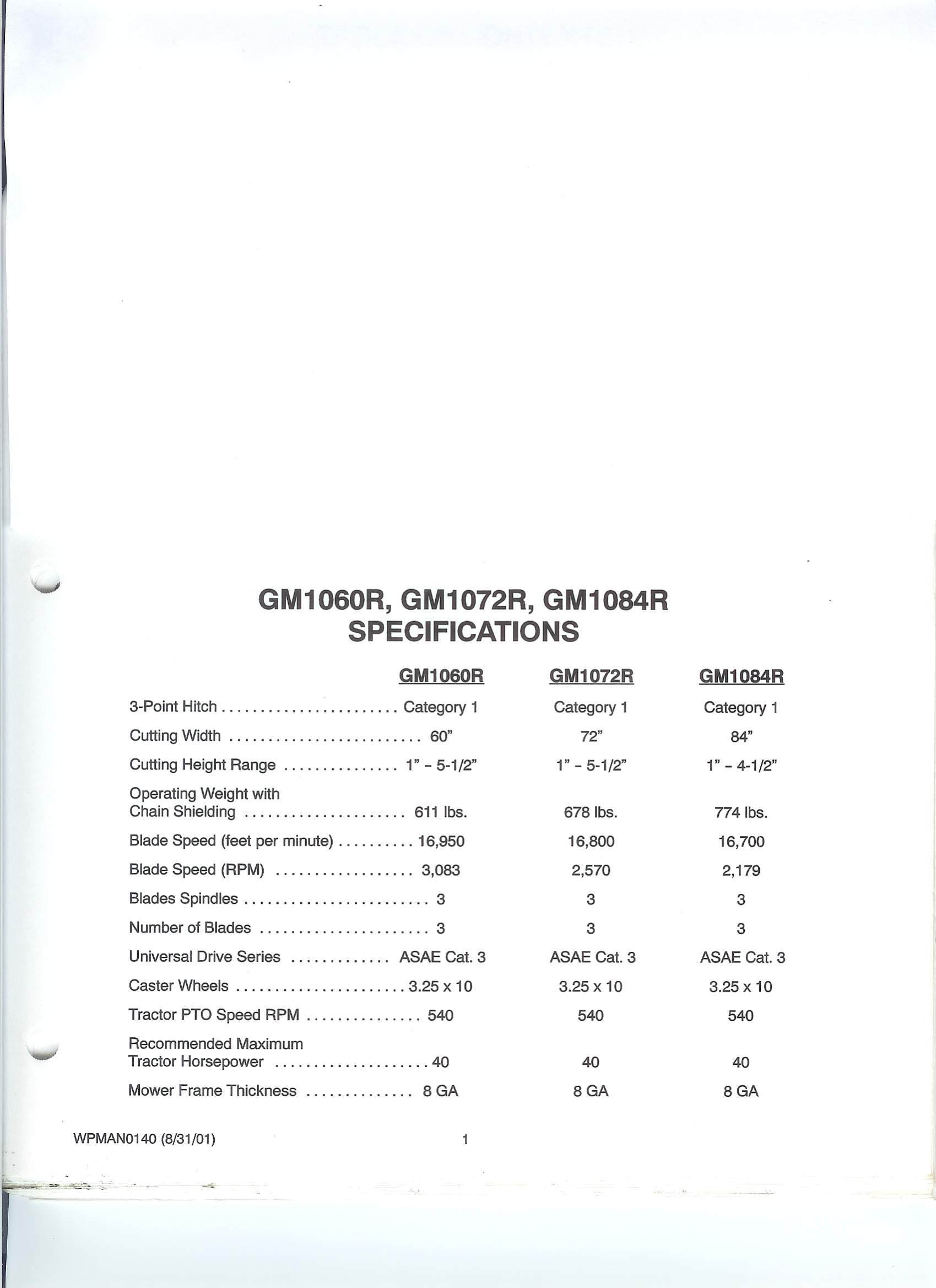

I think my 4 ft Howse rotary mower is around 450 lbs.
Since I have a front loader, I've never thought about ballast to offset it.
   / Trying to learn about the old Yanmar Tractors #12
Here's the Specs. to the Frontier FM's.. 611 Lbs. is correct for the 60". It's up there and no wonder I had to add front ballast. Which I had to think about. That was the weight before of the Anchors when I started filling it. I got the sledge hammer out and Packed it solid with another I found after I started. It's at least 70lbs. There's some things on this model that's usually not normal on a FM. with the way there built I've noticed. A good example is the steel bar that supports the wheels. Just about every other one is hollow. And the metal they used on the deck is Hefty!! 8G. There's no doubt these specs. are correct Imo. Plus I scanned them out of the Org. Manual. ;)
