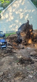

Here is what the underside looks like. I am hoping to burn it in this position. Maybe that will allow the flames to climb. The problem with the burning so far is that I had to burn a lot of wood around the stump in order to burn the stump. I had to pile wood around it. Now, like this, I am hoping the flames will climb up the back of this thing. Other advice?

Containing the heat with a few pieces of tin or metal with help with the burn.
   / Trying to remove 50 inch oak tree stump with Bobcat backhoe. Struggling #43
Stumps can be hard, although can you cut it in half, else quarters with a chainsaw and lift it out?
That may actually be faster, more effective than burning at this point.

Yeah, I think I am going to ditch the burn idea. I think power washing and using the chain saw is the way to go. Draging it could work to. But, I would like to get it into manageable pieces that I can grapple with my smaller skid steer. Thanks.

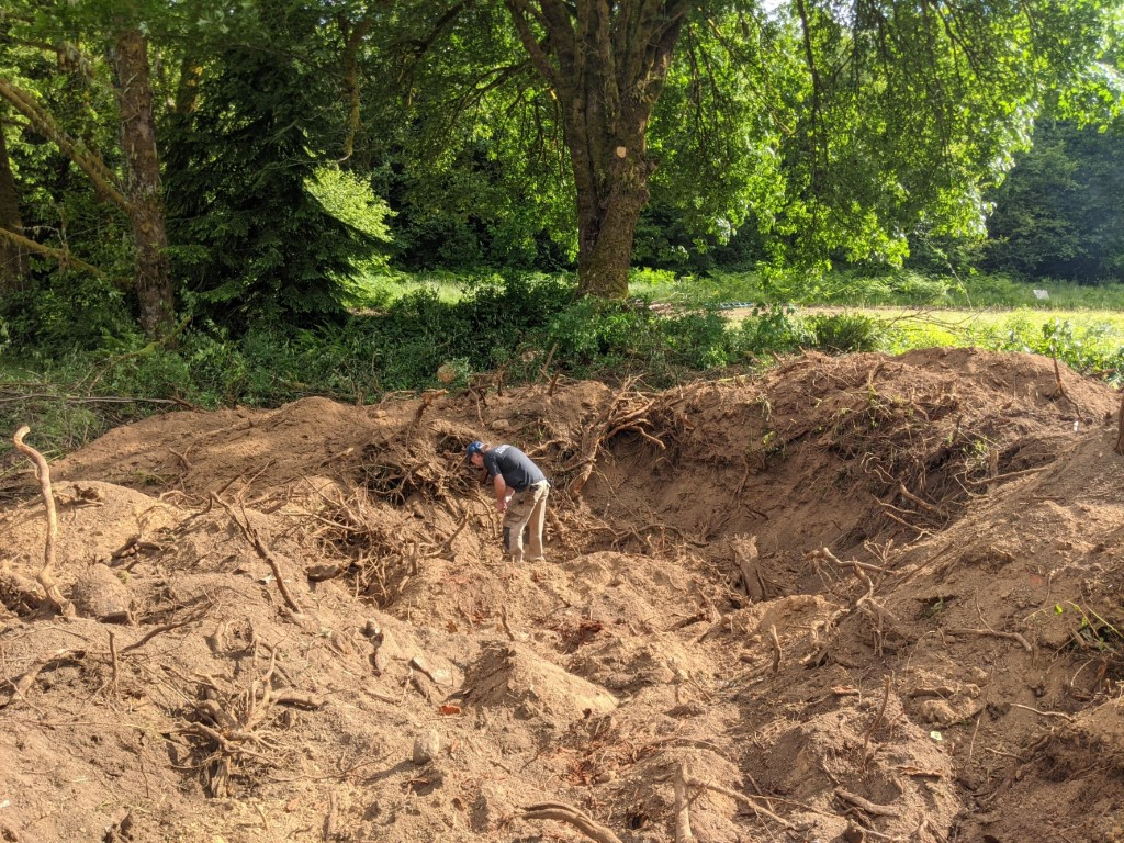

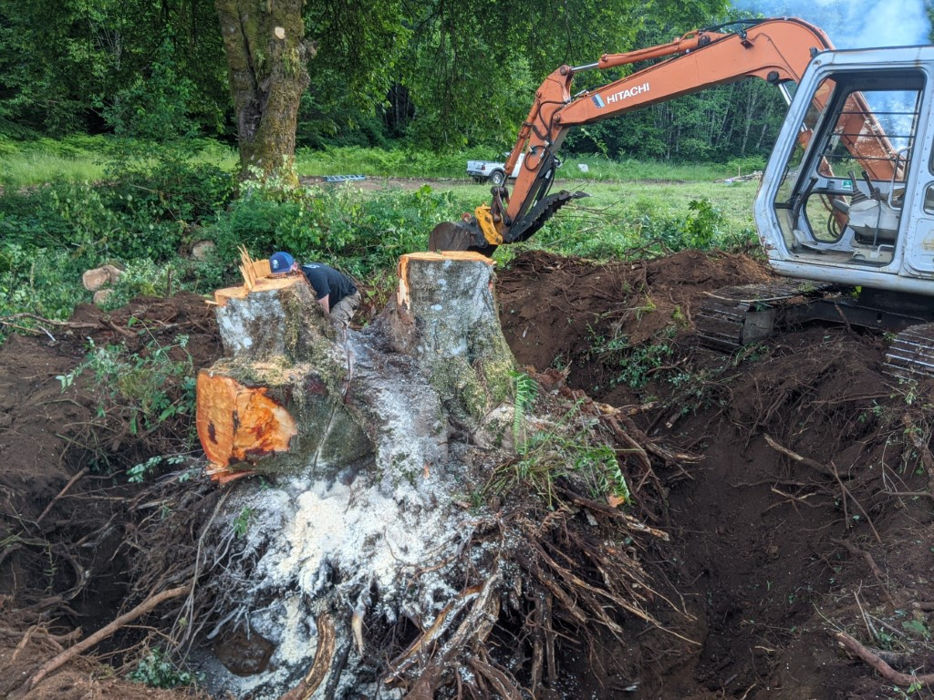

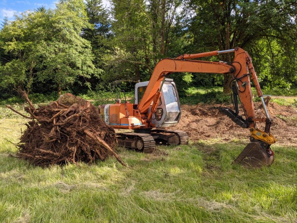

I recently dug out a multi trunked Alder with my EX60 and it took a minute. They are always bigger and go deeper than you think. I'd have left it but it was right in the way of my friend's future driveway. We just pushed this out into the woods to let nature do it's thing.
