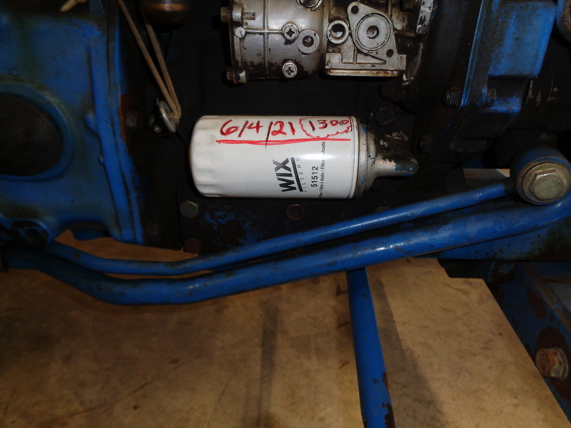

Wix 5152 is right filter for 1700. It will set you back just under $8 and it is a really good quality.

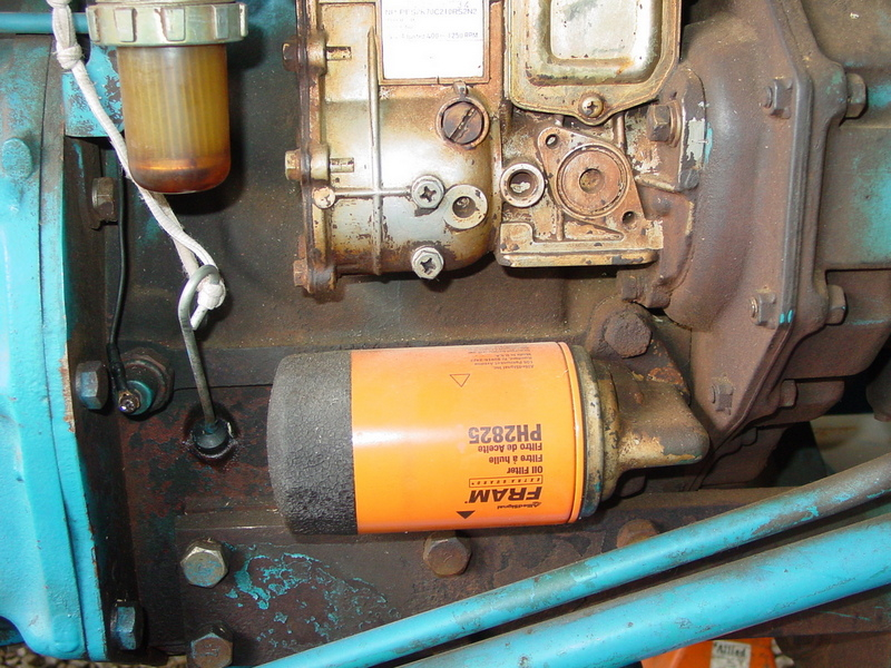

Fram PH2825 is also compatible, for around $6 from Wally World. Not as good a quality like Wix but ain't so bad in a pinch if you change oil regularly. I do mine every 50 hrs so the oil really is never that bad... just cheap insurance.

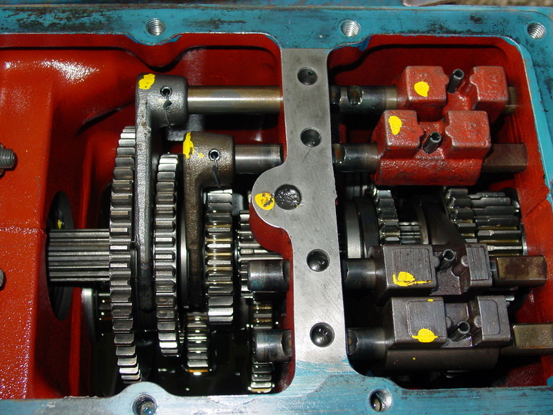

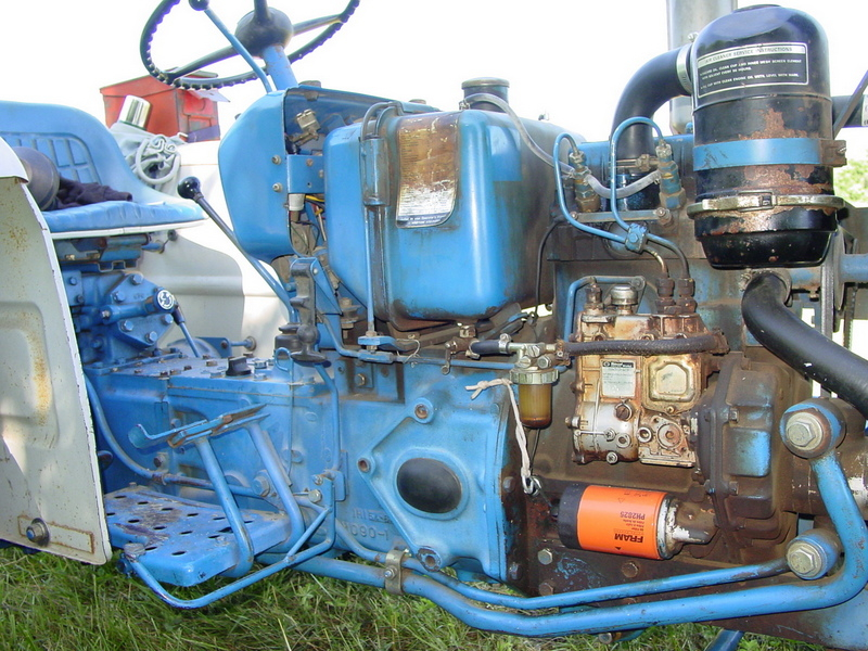

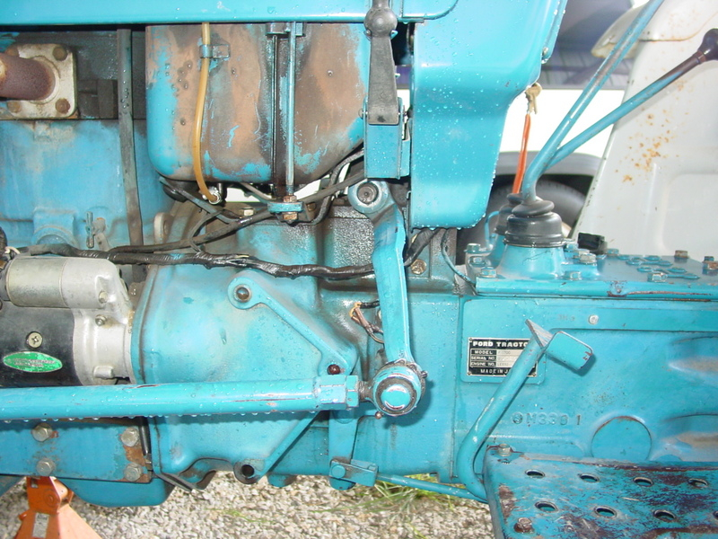

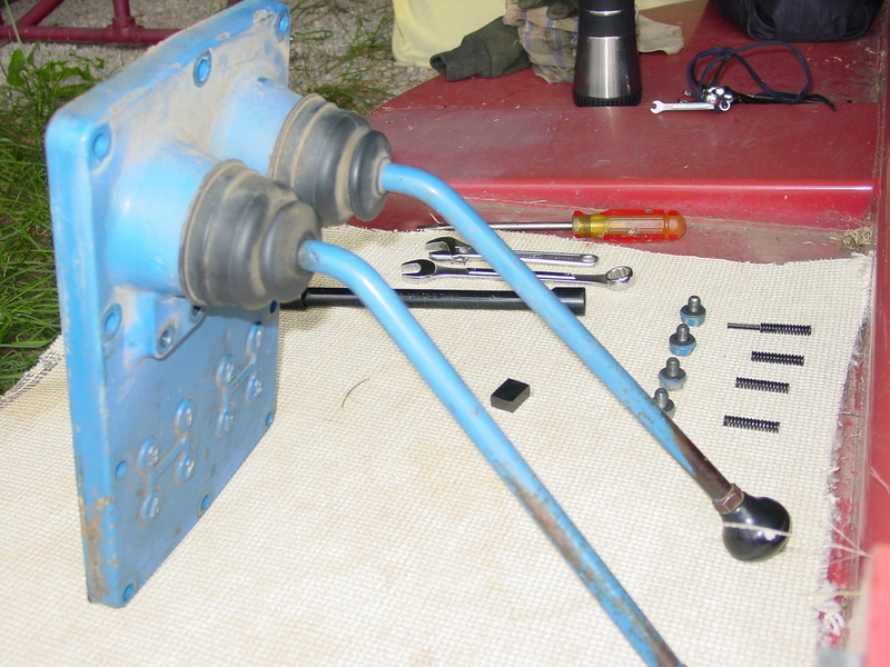

If you have gear shifters then you ain't got hydro transmission. My rigg is a geared but not synchronized, meaning you cannot change the gears on the fly as you do with manual car transmission.
inside of the transmission.
I have an '83 4WD and an oil air filter. Never seen one before and sadly, ain't checked it since this wonderful machine was bestowed upon me by my neighbor who's hubby - who loved this machine - passed away unexpectedly about 8 years ago.
RIP.
The black cylinder thingy there is an air filter. it does have a bowl on the bottom that you fill with clean oil. Air is peculated thru the oil media , gets scrubbed and intake will have clean air. Every year or so you take the bottom bowl out, discard the oil and bunch of dirt, clean , put some clean oil back in the bowl and you are in business. Never need more than that.

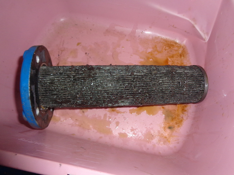

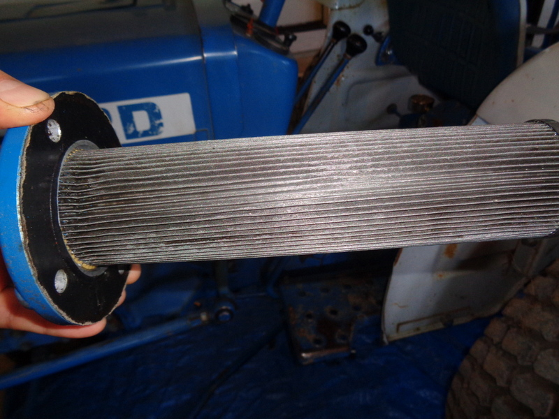

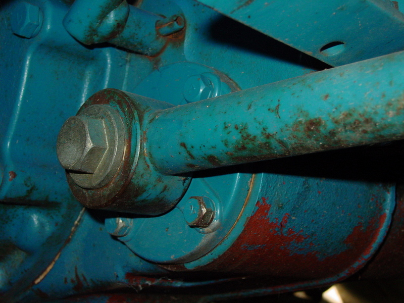

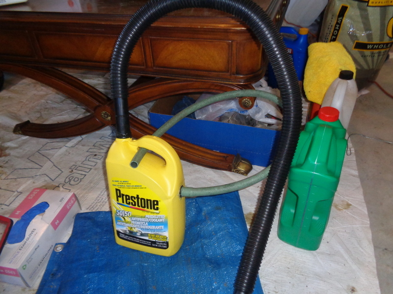

There is a screen in the diffy attached to where the discharge form the pump (the fatter pipe ) connects to right side of the diffy. That needs to be removed to have access to the screen. Once screen is removed then you have a hole on the side of diffy that you can vacuum the floor with a shop vac. in order too avoid getting oil in to my shop vac I made a collection system same as what is used in dentist office or hospital OR. I have pics here. Ask question if you have.
Follow suction line from the pump to this fitting below. The banjo needs to be removed and then 4 bolts to withdraw the screen. The hole is where you go in to clean the bottom of diffy. Now , I don't know how many people actually have done that but when I did it I removed more than 2 quarts of mushy black muck out of there.

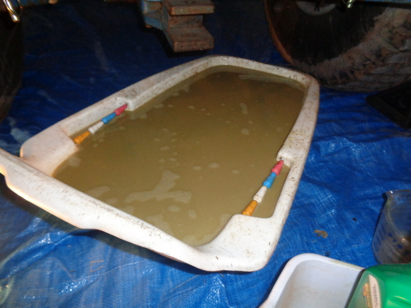

This the condition of the oil when I did it. I think it was probably the first time it was done.
i use all my resources, all my boys shared the same baby tub for bathing when they were under 1 yr old. I have not given u on that yet:D
when I removed the drain from the bottom of diffy, nothing came out as the hole was blocked with crap. Made a hook thingy from clothes hanger and shoved it thru the hole and when I pulled it out a dead rat looking glob came out. That's what I removed and then vaccu sucked and cleaned the bottom of diffy thru the howl I withdrew the screen.
