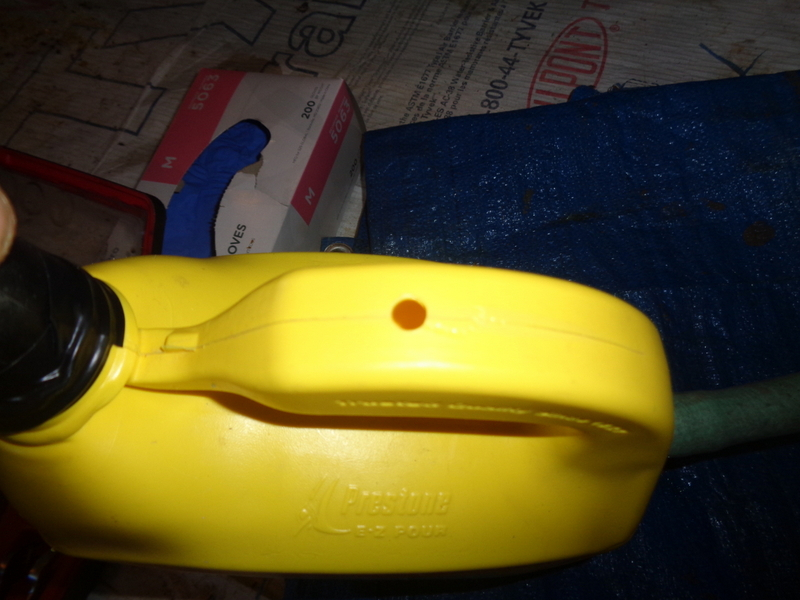

Great stuff, JC. Love the vacuum adaptation - I'll do just that. Forgive me, brother, but what the heck is a "diffy"? Differntial?
You are welcome. yes sir, it is differential housing. Notice the hole I put on the handle of the jug. The reaso is the suction of shop vac would not suck the container as it is not very stout plastic. you can blocl it with your finger to regualate the suction.
