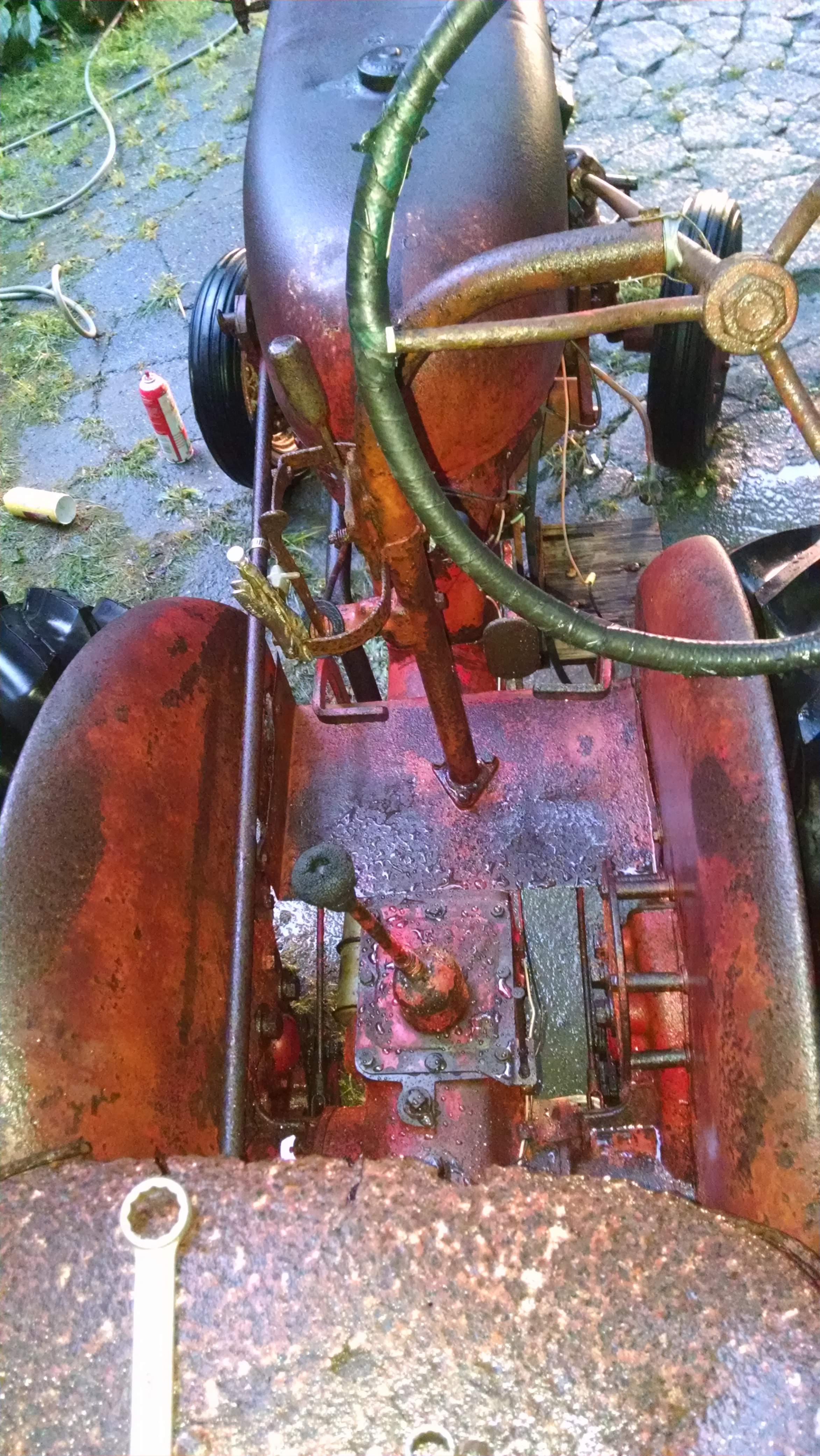

Well the cub is up and running. Pretty good I might add. Tranny sounds horrible, but is working in 1st and reverse. I think it at least needs new bearings and shift forks. Were calling it mater. My buddy is thinking about restoring it, but keeping the rusted look. Got the Massey pulled out of the weeds and ready to put on the trailer. IMG_20150814_241410566.jpg

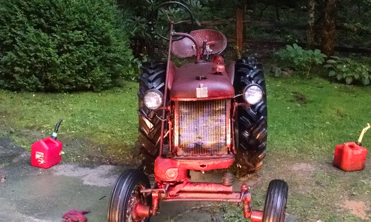

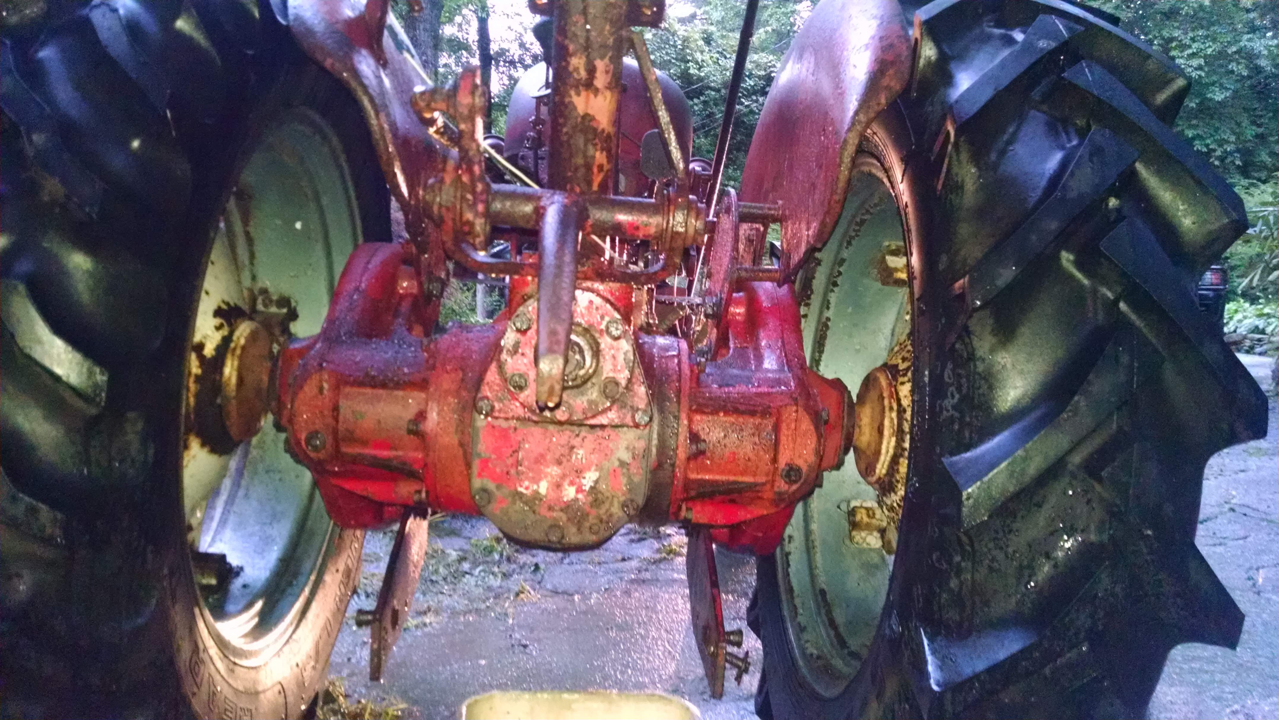

Well we got them both home. Here's some pics of the cub, might be something special. It doesn't have the offset motor like most of them do.
We've heard that it was probably custom, but could be factory or not, and was probably made for vineyards? If any one has any info it would be appreciated. We can't find another one like it.
