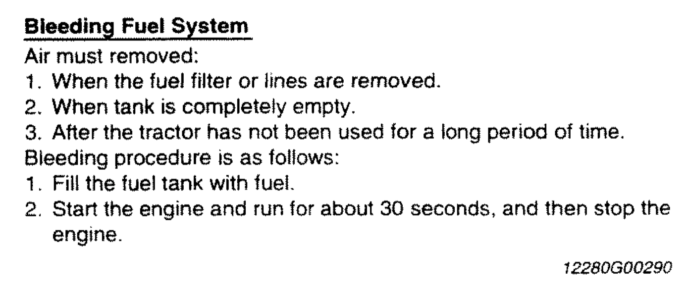

   / Trying to start kubota b7800 #4
From repair manual

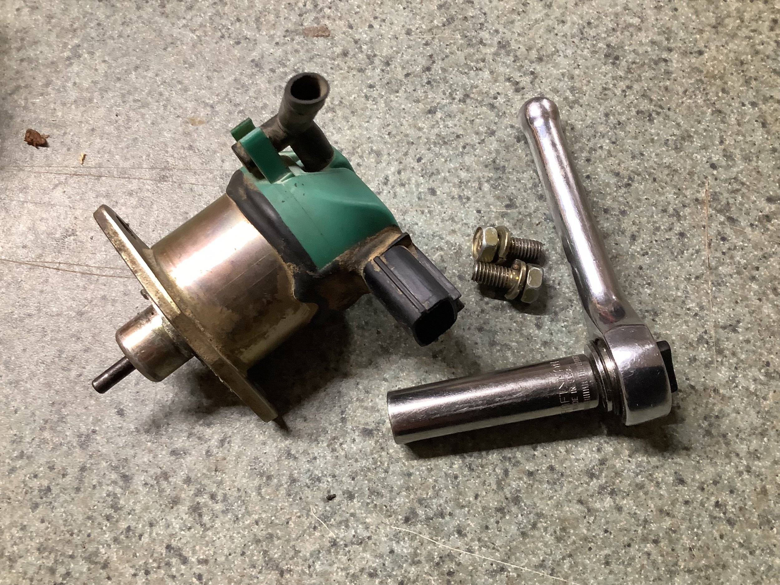

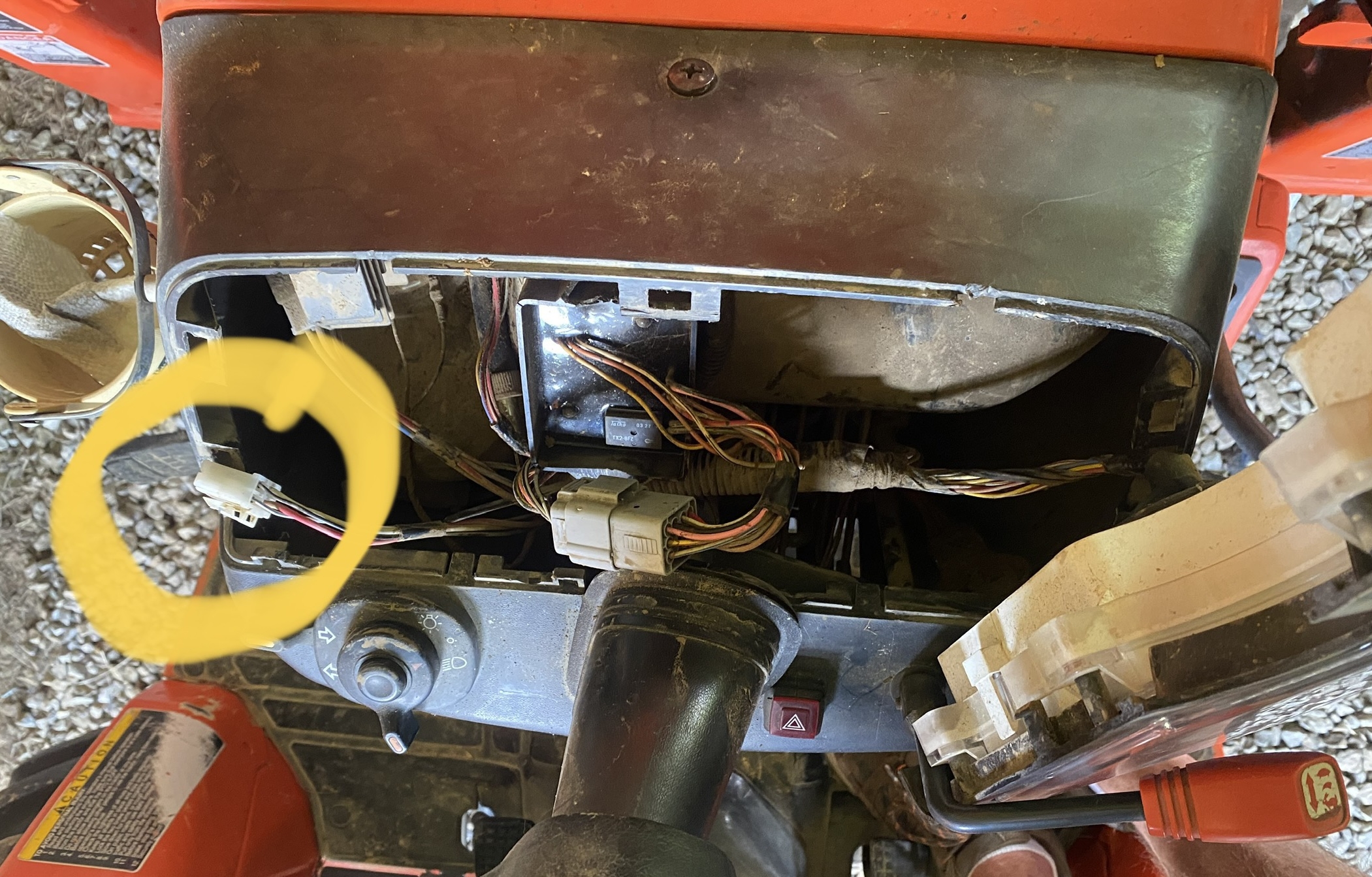

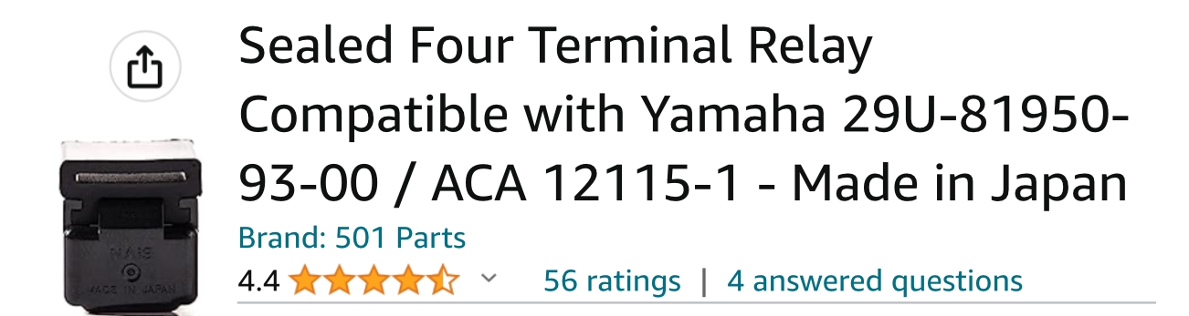

Are you hearing the fuel stop solenoid click on key turn? My B7800 would crank but no solenoid click, no start due to no fuel flow. I removed the fuel stop solenoid for troubleshooting and it started (have to stick a finger inside to momentarily depress where the plunger hits to kill the engine). Just posted the replacement relay and solenoid fix today. Don’t know if its your issue but here is the post.
IMG_3258.jpegIMG_2877.jpegIMG_3257.jpegIMG_3078.jpeg Best of luck.
