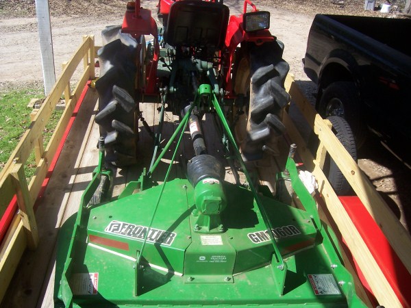

9.5/9 - 24 Bridgestone on mine. I believe they're Org..

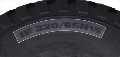

Old thread, but the OPs original posting sheds the best light on Ag tires of the old x.xx-xx sizes to the new IF-sizes that are metric based. My front tires are cracking badly only after 8 years (Milestone, China made). Replaced 1 tube in November, now the other front wheel tube is shot. The tubes will not hold up as the tires are too weathered. So, I got to find or put on order something very soon as Spring is nearly here for tilling!
My YM2610 Parts Manual shows the fronts are 7.00-16 or 5.00-15. The 5.00-15 = JD850 and other JD Yanmar machines. Thus, it shouldn't be too hard finding tires right? LOL
Well, I got sort of displaced looking for the 5.00-15's because a majority of the Ag tire charts to the IF-size conversions begin with the 6.00-14.
Is it that hard to find SCUT and CUT 2WD tractor tire size conversion?
Additionally, the rim mentions 4.50E. Not a clue as to what that means either. It's the same on a JD750, JD770, JD850, JD870, JD950, JD970, etc. for 2WD front tire options.
I'm fine hunting for vehicle tires. Ag tires are not so straight forward yet to my thinking.
Looking locally at the Farm and Fleet store, they have a 5.90x15SL. Would this mean the tread area is 5.90 inches wide vs. what I have now as 5.00 wide? Or is that the profile height of the tread, thus I have it all wrong.

Often the tire size will include two numbers which are the measurements for the radius and width of the wheel that the tire should mount on. It's not uncommon for a tire to be double labeled in inch and metric. If there is a standard system I don't know it. Yours looks to be designed for a wheel 15" in diameter and 4.50 means a width between the inside mounting faces of 4.5". R usually means the tire is made with "radial construction"
Other numbers usually relate to either footprint or the inflated width of the tire. Rarely is the outer diameter or circumference noted.
For the 5.90x15SL that means the tire is designed to be mounted on a 15" rim with 5.9" between the inside faces. You can mount it on a different width rim. Give or take and inch and it won't matter. Maybe you can get away with even more. All it will do is change the inflated and loaded measurements. But you have to measure those for yourself anyway. Bottom line....will 5.90x15 work on a 5" wide rim? Yes, probably work fine. And it will have a different tread contact with the ground and a somewhat larger circumference.

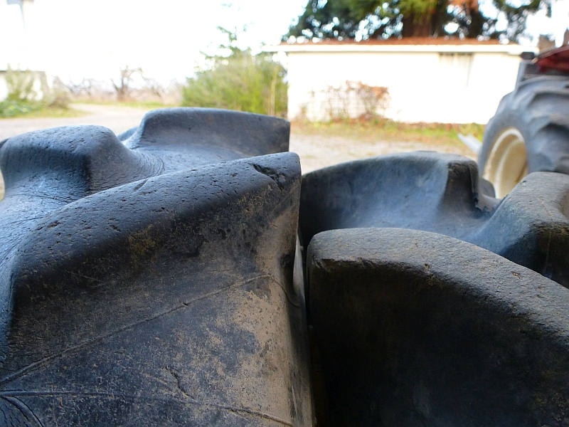

Stuff I've read FWIW - I've read that the first number is the width of the casing, relevant for a truck's duals, for fender clearance, etc. But we've all seen cheap tires that are smaller than quality tires of the same nominal size. Then on car tires, the -70 etc is the proportion of height to width.
But relevant to our Yanmars: Here's a photo showing two similar tires that are vastly different in size.
500x12 vs 5-12.
5-12 is what Yanmar specified for the front of YM186D. Apparently an obsolete spec and hard to find. But the big ag tire wholesaler/dealer for California's Central Valley (huge ag region) had a pair in stock.
The taller 500x12, in contrast, is what was on my first YM186D when I bought it. That tractor had been used mostly for blading snow so its front/rear ratio mismatch hadn't caused any damage but I expect if it were run on dry pavement it would have bound up badly.
(I put the used proper 5-12 tires on that tractor before I sold it and bought new 5-12 tires for my second YM186D, the one with a loader).
So - I think its necessary to find the precise size Yanmar specified, to avoid a mismatch as bad as this. Good luck finding them.
