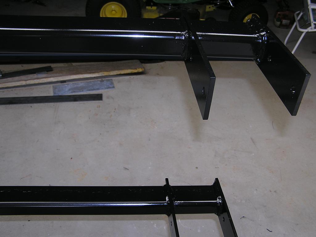

Picture of ROPS before mounting on tractor.
Lower plate view 1

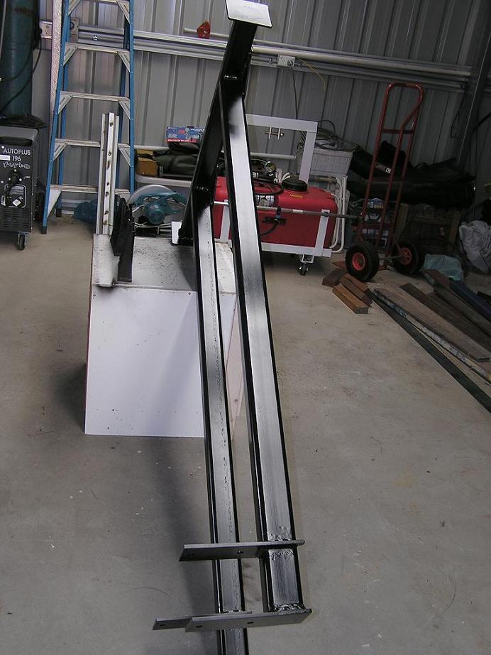

Lower plate view 2

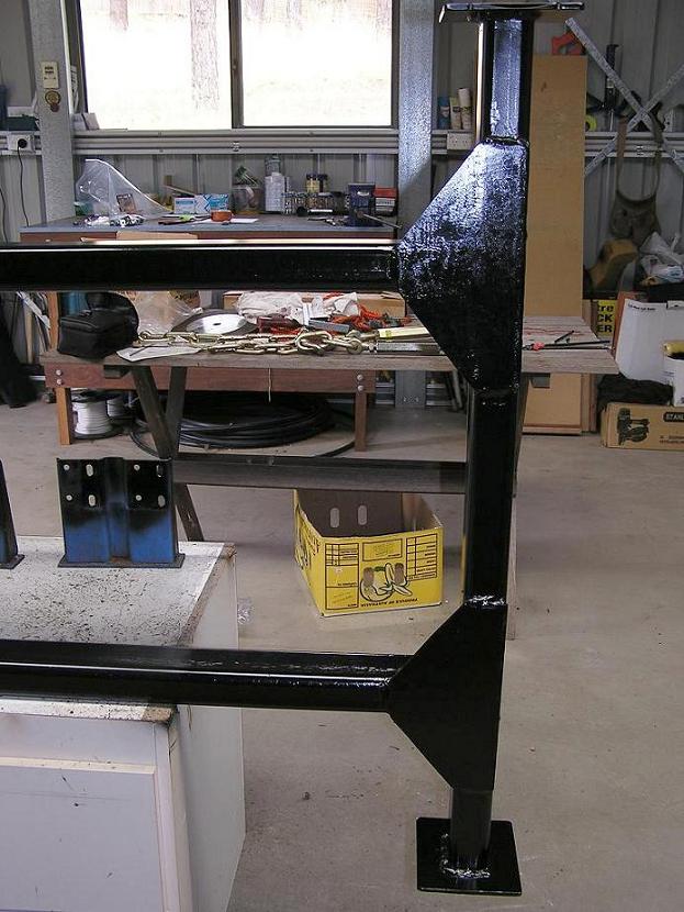

Top. shouldn't have used galvanised plate, #**### to weld!

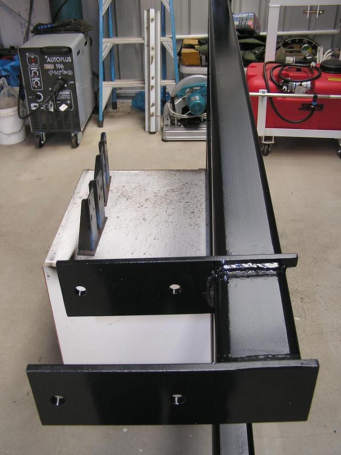

Whole thing worked out pretty good,very solid, just need to get a hand to mount it up and get a seat belt fitted. Only mod from above drawing was to elongate the cutout in the top plate slightly. Only mod to tractor will be the hi tensile bolts to mount it and elongated vertical holes on the mudguard mounting brackets. I'll post a picture when I get it mounted.
