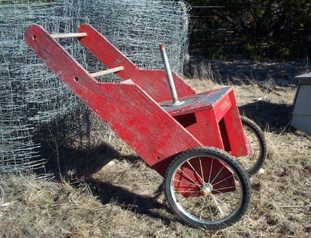

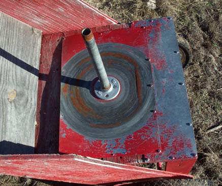

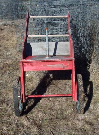

Attached are some pictures of a device built mostly from scrap materials to help you with your fencing problems. That is if you are just putting up barbed wire. If you are putting up field wire, now that is a horse of a different color.
I have been using this "wire wagon" for over 5 years and it has never let me down. Bigger wheels would have been better. The ones on it are 12 inch.
Pic 1: Side view shows the overall design. The 1 1/4" pipe on the floor goes through the center of the wire roll. Fasten one end to a post and pull away.
Pic 2: Rear view.
Pic 3: Shows the sheet metal on the floor with the pipe stand.
