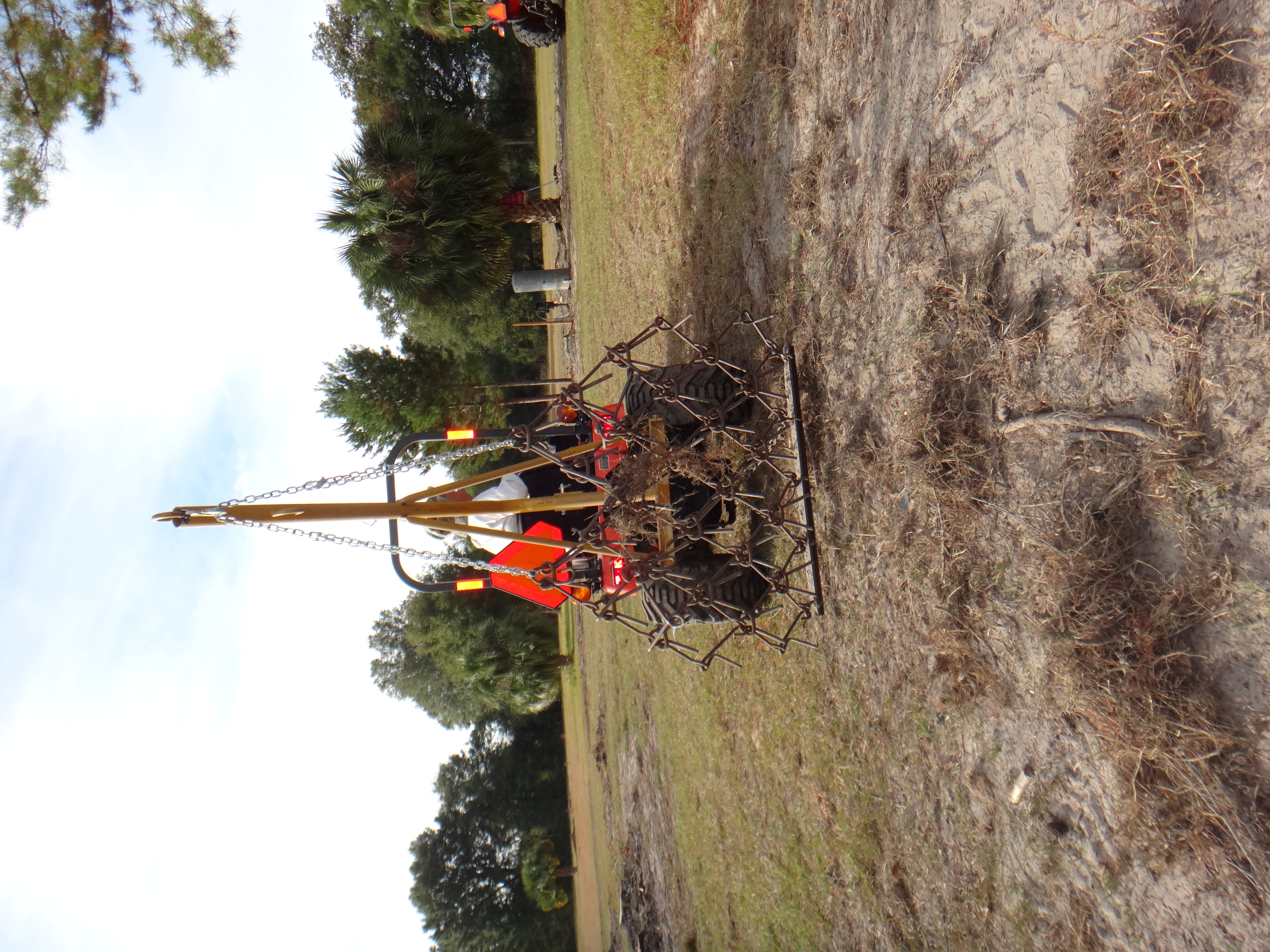

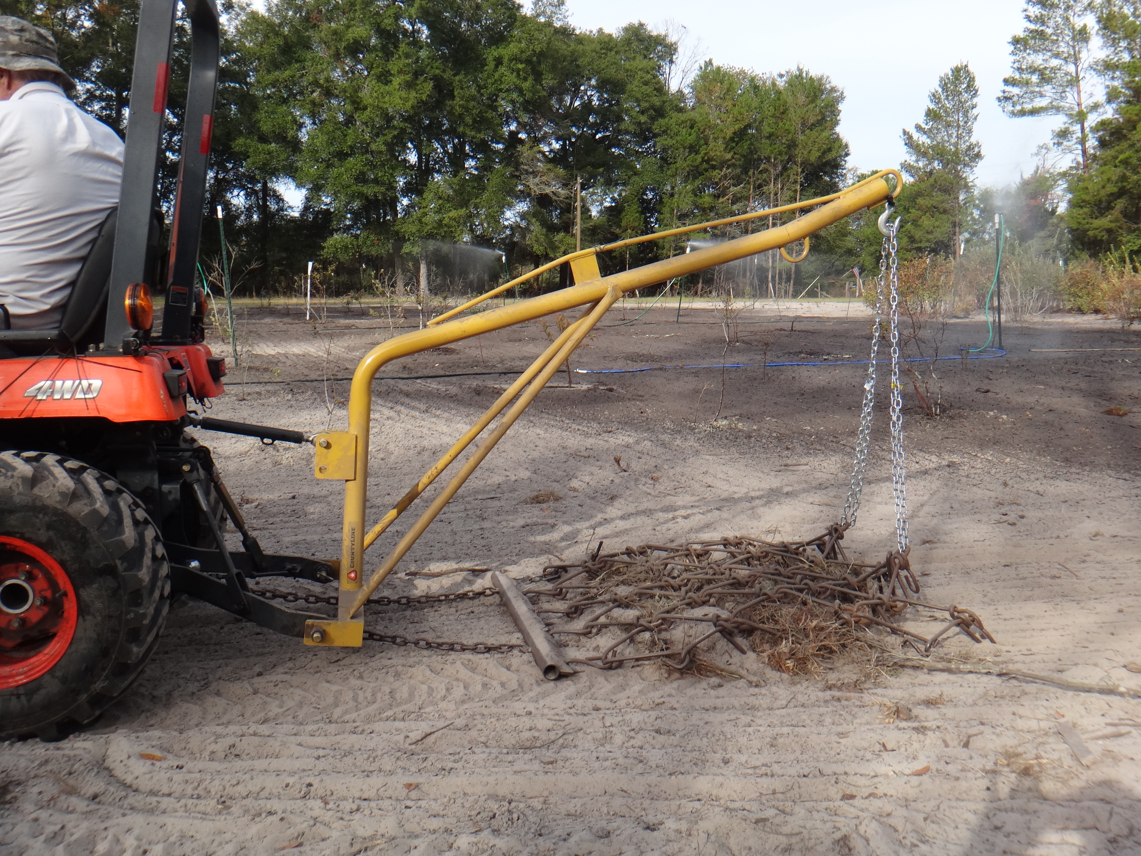

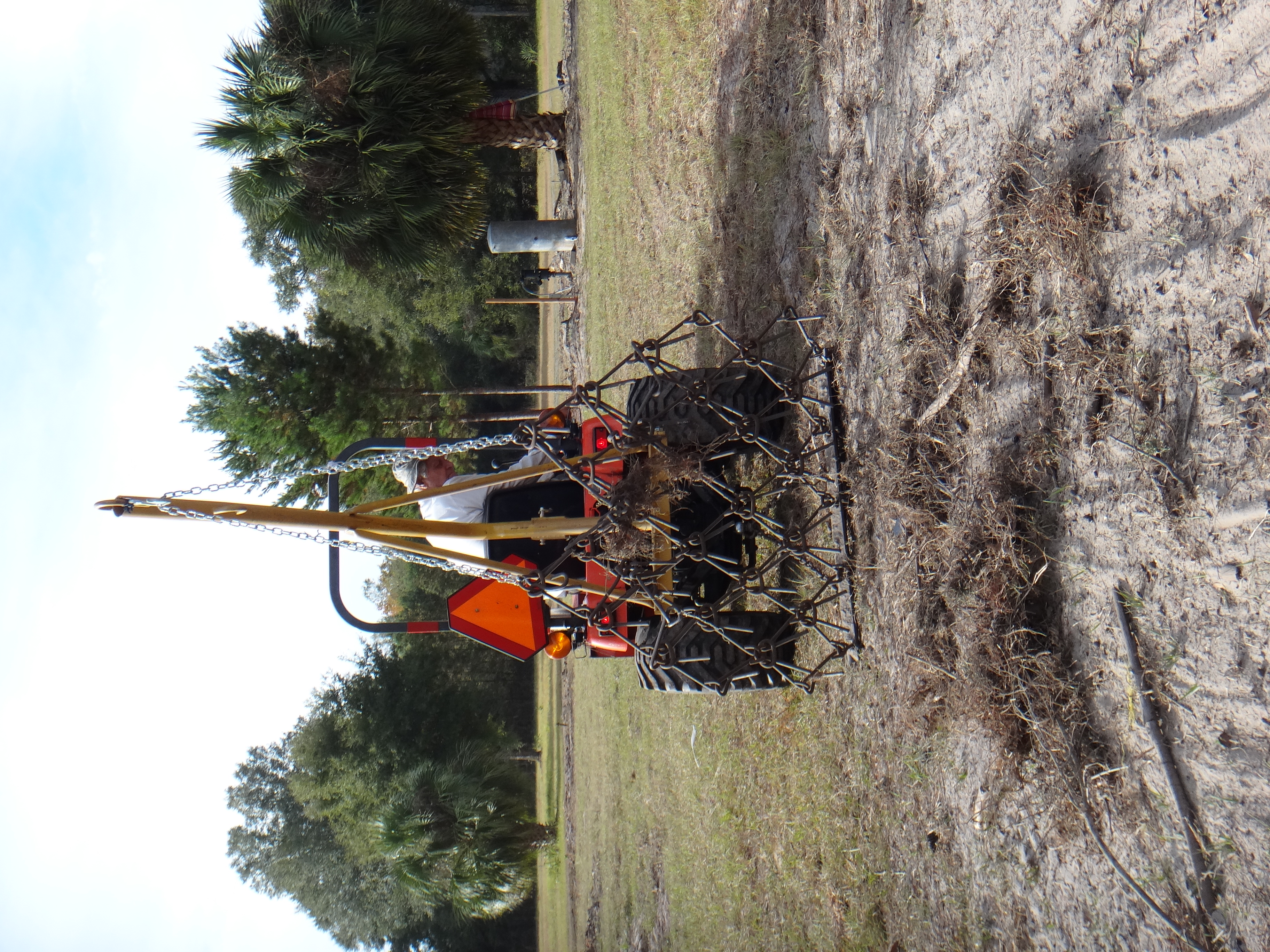

Photo #1 Tarter Farm & Ranch Equipment, in Kentucky, currently produces Tractor Supply Company's CountyLine (brand) implements.
Photo #2 LW Boom Pole connected to 4' X 4', 89 pound, Loyal (brand) Chain Harrow by 2 X 10' lengths suspension chain. In Photo #2 suspension chain is adjusted a little too short, rear of Chain Harrow is not quite flat on the ground.

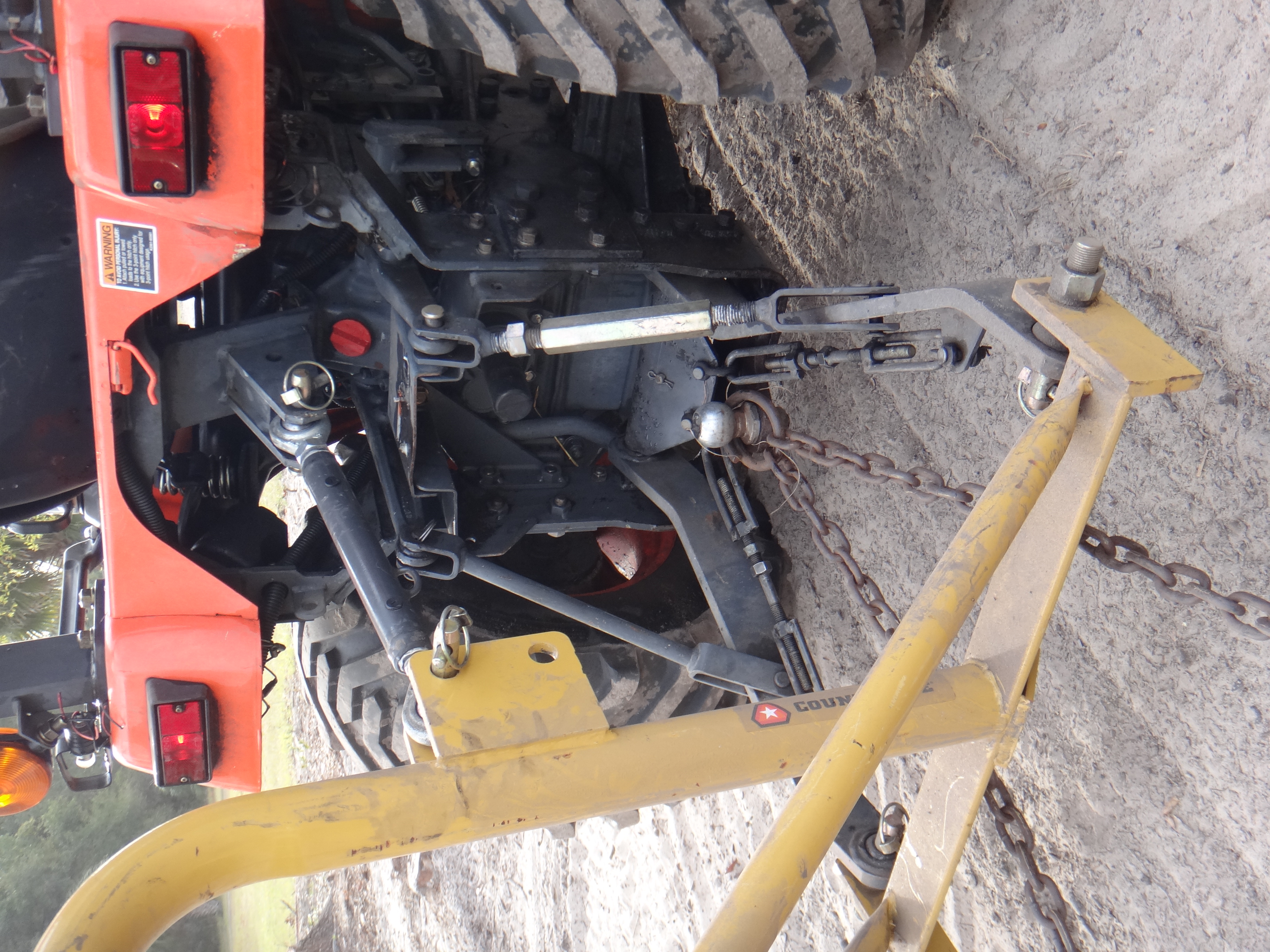

(Lower Link stabilizers should have only a tad of slack so distant tip of Boom Pole is consistently positioned, not flopping around.)
Here is chain I purchased at Walmart to suspend the harrow mat, two boxes:
https://www.walmart.com/ip/Peerless-2-0-Passing-Link-Chain-10/36442107
A passing link chain's wide link design allows the links to pass each other reducing tangling and kinking. Used as a general utility chain around the farm and other industrial applications. Warning: Not for overhead lifting / Do not to exceed the working load limit of 450 pounds.
Photo #3 Boom Pole in lift. Lift is not as high as desired. Tool bar still on ground, potentially interfering with tractor rear wheels when driving in reverse.
Photo #4 Chain shortened. FULL LIFT OF CHAIN HARROW FOR CLEANING DEBRIS, which drop to ground. Tractor/Harrow can be moved in reverse. Note in foreground: harrow collected detritus which dropped from raised mat.
Photo #5 Showing Chain Harrow attachment to BX center drawbar ball hitch. Also shows Top Link positioned in upper Top Link pin hole on Boom Pole. If Top Link pin in lower hole, only partial lift of Chain Harrow possible.

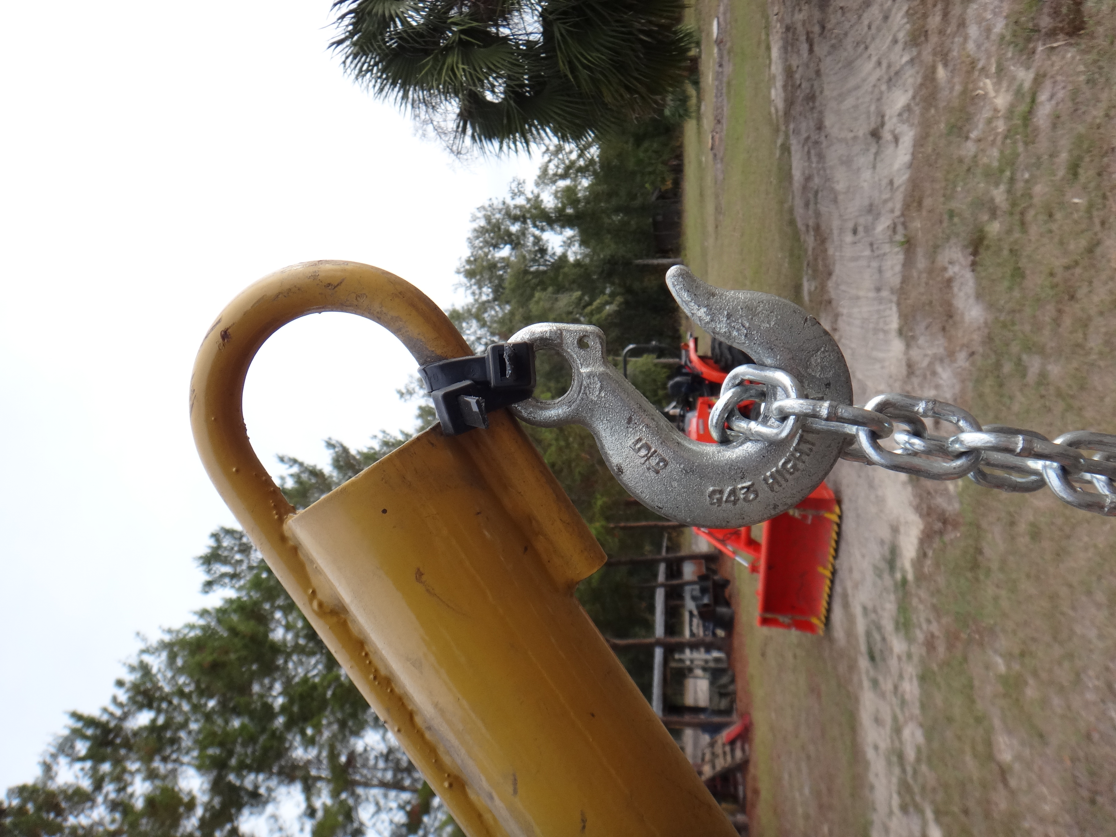

Photo #6 Slip hook suspended below Boom Pole upper ring using HD nylon cable ties, to prevent abrasion to Boom Pole. Chain is free to equalize from side to side. Chain Harrow can be separated from Boom Pole and tractor in ten seconds.

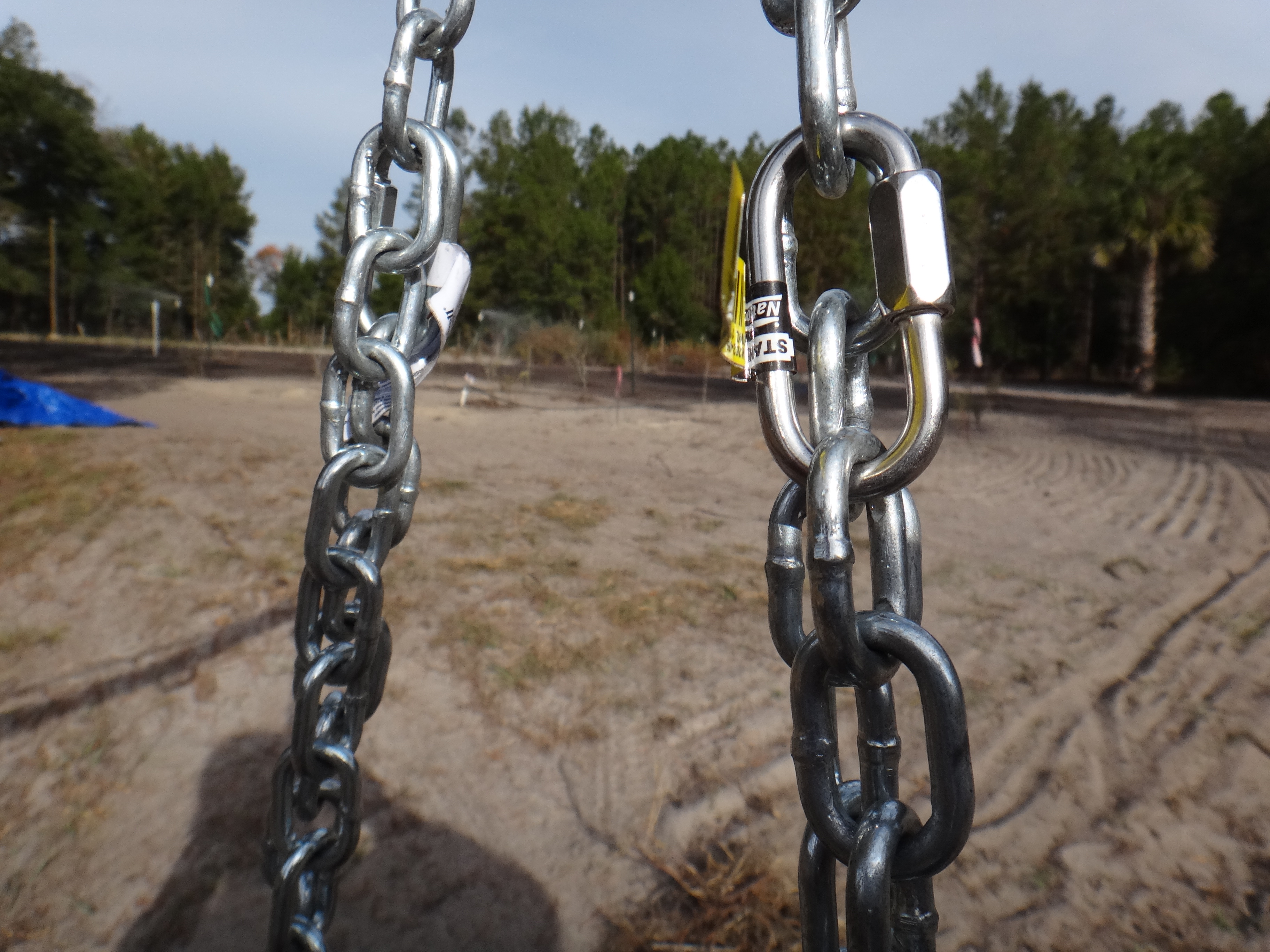

Photo #7 3/16" Quick Links used for suspension chain adjustments. 3/16" Quick Links max capacity 660 pounds each. Adjustment is half way up chain to minimize dirt accumulation in Quick Links.
This improvisation has been 100% satisfactory. Chain Harrow pulls easily in its most aggressive position. Chain Harrow self-cleans when raised by Boom Pole. Tractor/Harrow can be reversed down rows when desired.
And ~~~~KISS.

RE: Photo #7
It is important chain can slip as harrow is dragged in a circle. Outer edge of harrow will travel farther than inner edge. Inner edge has to feed more chain to outer edge or harrow mat will fold up. In Photo #7 a Slip Hook functions like the differential in a vehicle transmission. A steel ring with the chain passing through would feed chain the same way.
