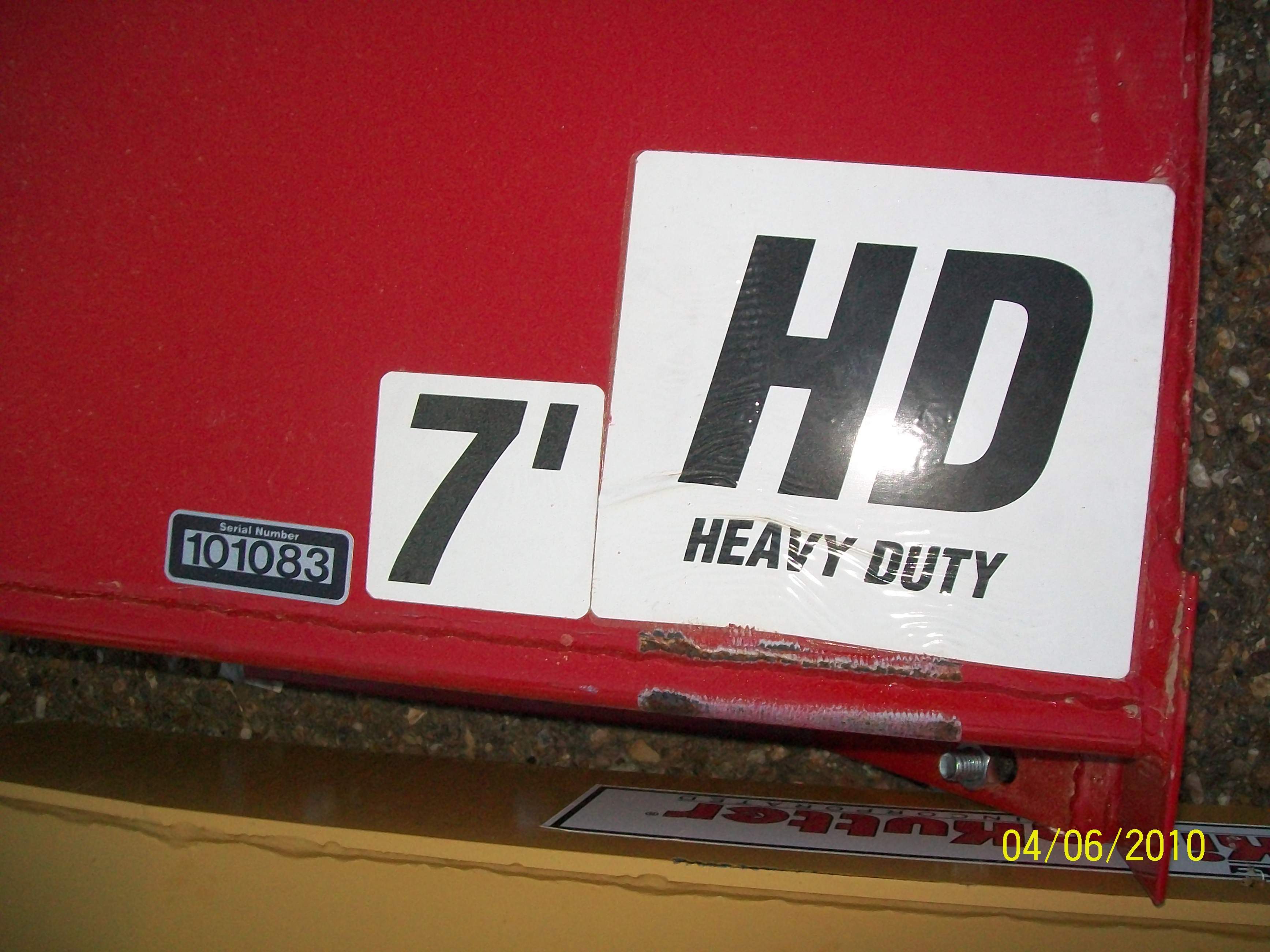

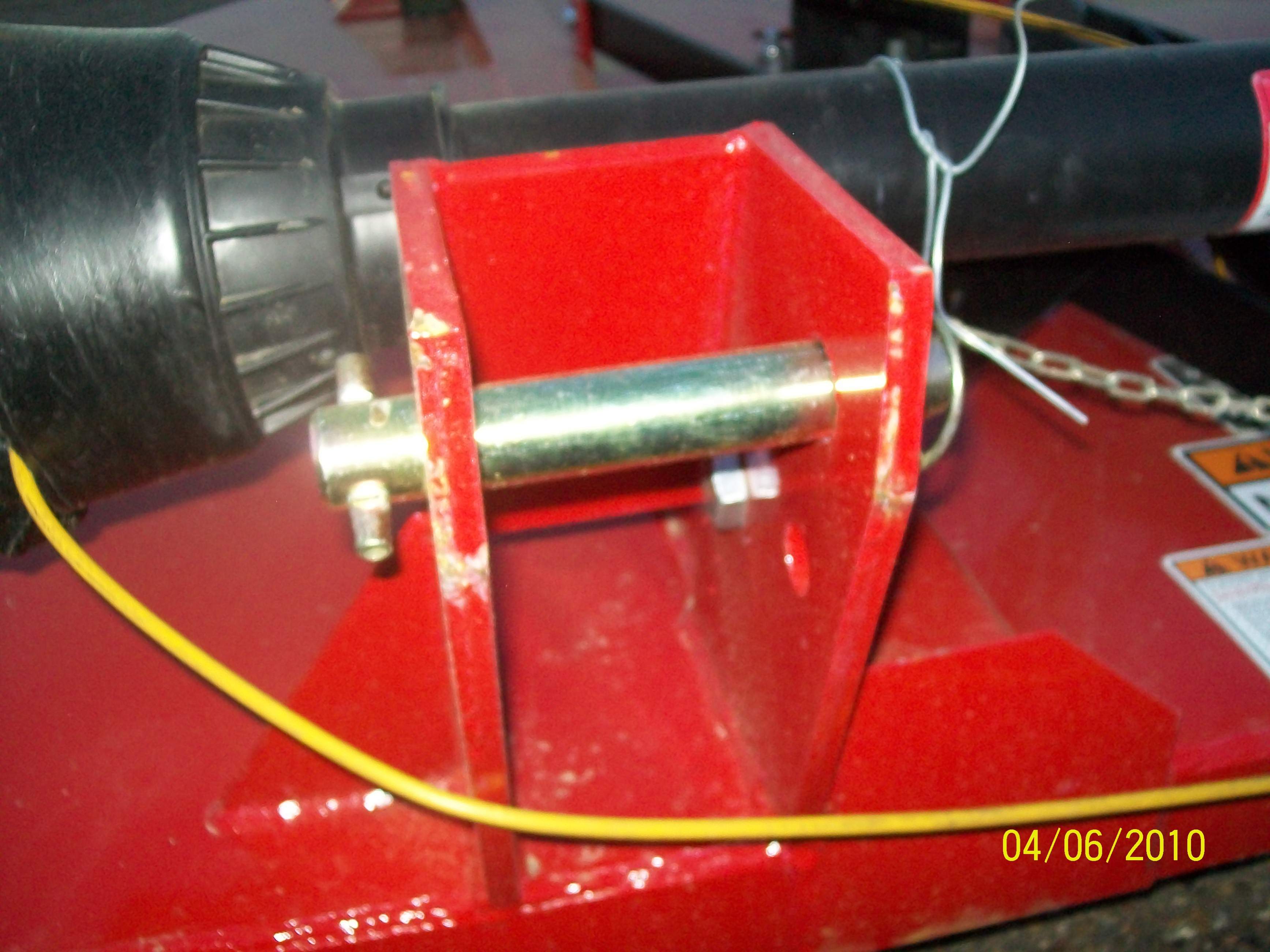

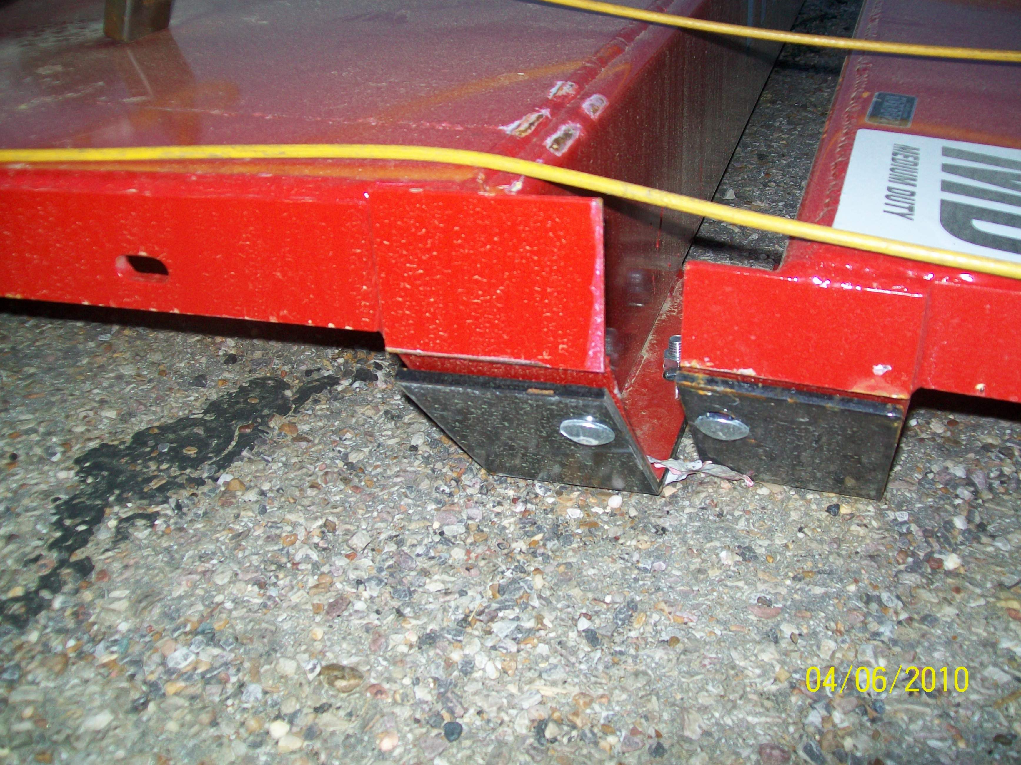

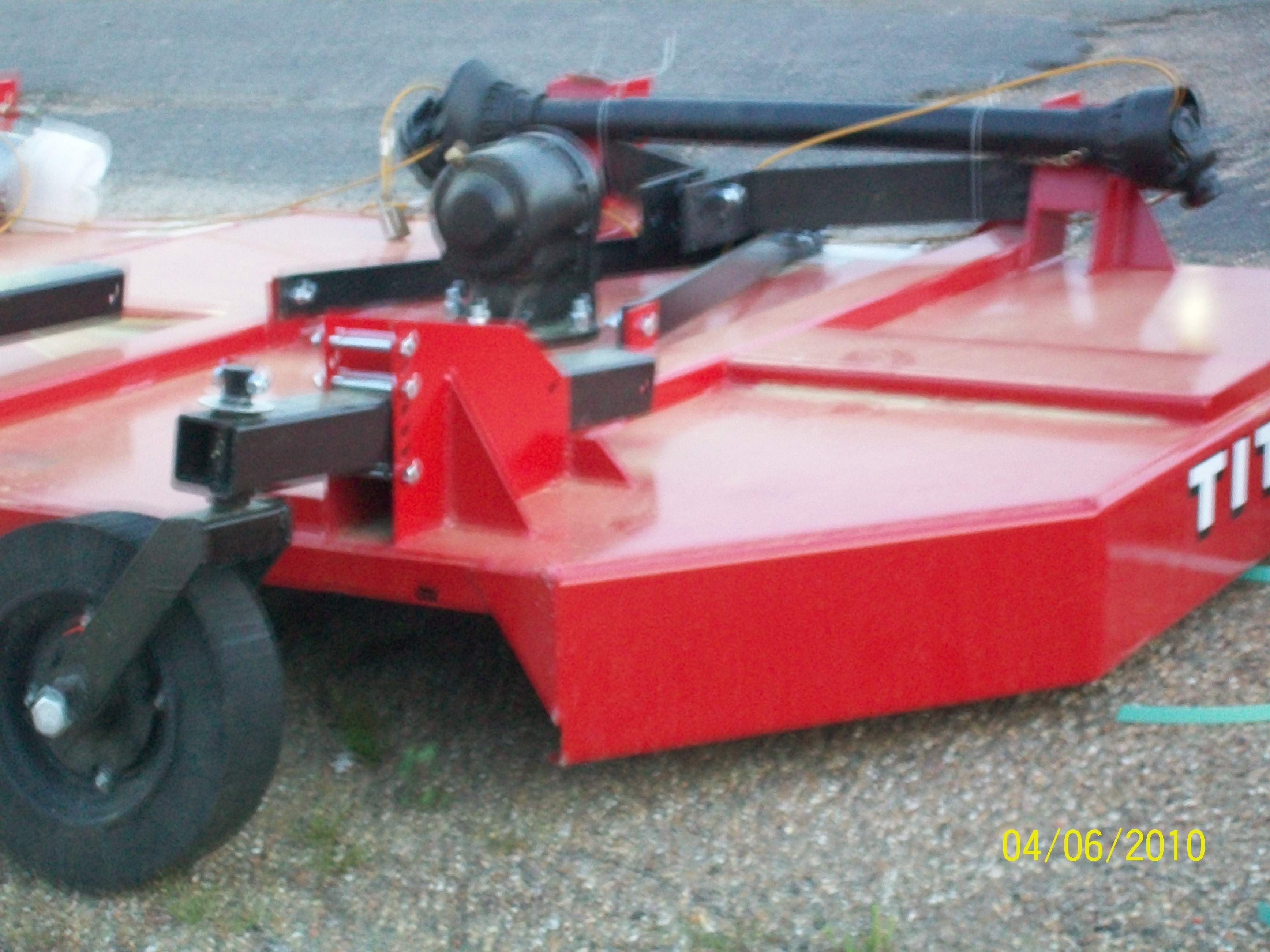

more pics

I believe that the major week point on this cutter is on picture #4 where the bar bolts to the metal on the top center of the deck. Would be better to weld another piece on the other side of both bars and have the bar bolted in the middle with weld on both sides. This seems like an area that takes most of the weight when deck is raised. I really see no other issues with this cutter other than the standard TSC gearbox.
