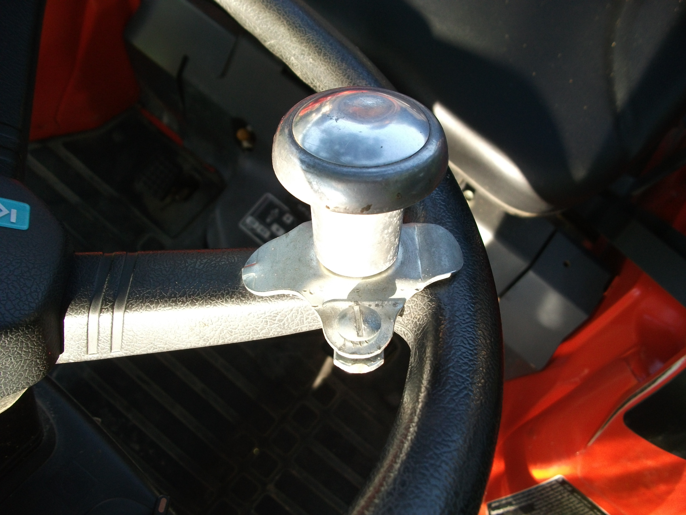

See if this will help. Cursor over the steering wheel and click to see closeup. By using this knob and the R or L brake "she'll turn on a dime and give you 9 cents change!" :D:thumbsup:

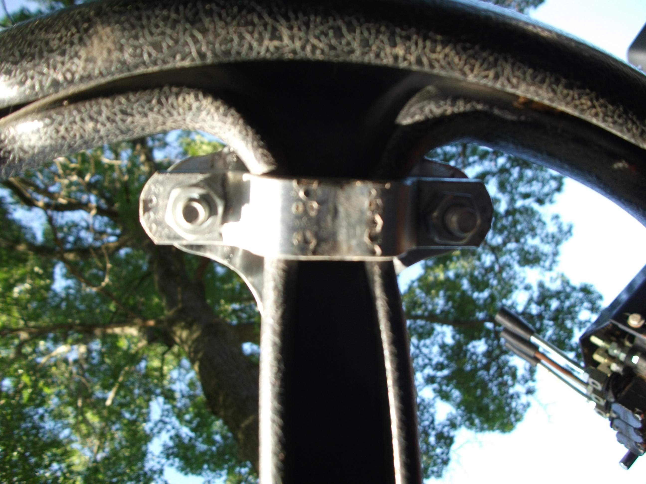

Jayste - yes, thats the one I have. The bracket just doesn't seat right on the wheel. I guess you have to lay part of it on a wheel spoke you did? Those Lowes ones look much more simple.

On both my L4350 and B7800 I put my steering wheel spinner on the left side when the wheels were straight and to this day that is where they are.;) Perhaps John Deeres are different? :confused: I did have to modify the bracket so it would fit the spoke of the steering wheel. You can see the vise marks in the pic. I picked mine up at a local tractor dealership for about $8 each. Always the first thing I do for my tractor. Would not be without it!

I use longer bolts with the universal spinner knobs from TSC. It will work with most newer steering wheel. You do not need to get it really tight. It will dimple the steering wheel somewhat and still not be too tight.
Many tractor dealers will have the spinner knobs you need. They are designed for the thicker style of steering wheel found on more modern tractors.

General Lee, I mounted mine just like MagiCheater did and it seats properly. Yes, most of it is on the spoke with only the "lip" of it on the wheel.
