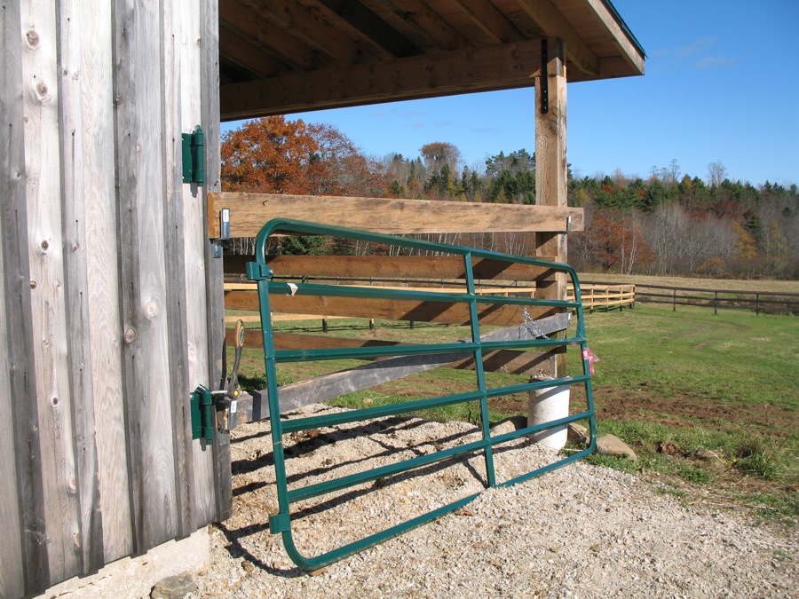

Hi All.I want to put one of those tube gate at the entrance of my barn which has a opening width of 10'.My question is do i get a 10'gate or do i get a 8'? I was thinking a 8' to allow for the hinges and such.Or would either one work?Thanks for all input.

I think too long would be better than too short. Long would just close against the post, short would just be, well, too short.
/ Tube Bar Gate #3
Depends on how you hang it to barn - hinges with plate for leg bolts or hinges with 1" through bolts. Both hinges only require about 6" of return. So your 8' gate becomes 8.5' roughly. I would got with ten feet. If it overlaps opening - you know nothing can squeeze out!
The attached picture shows the ten foot gate going into place. The hinges have plates that are leg bolted into place. They are bolted into corner post of barn with 6" leg bolts.
Also think about clearance for swinging a 10' gate... takes a lot of room.

Oh Crap i forgot to mention that on the post where i would mount my hinges there are 2 one on each post the latches that secure the barns sliding door.They might get in the way of the 10' maybe the 8' is the way to go??
/ Tube Bar Gate #5
If you have sliding doors - we have. I would go 8 and slide door to edge of gate and fasten - that is if you intend gate to cover opening of the sliding door when open.

A gate typically will be undersized. If you have a 10' opening, a 10' gate with the lags etc will fit.
However, be aware, that gate opens both ways, but not all the way back onto the fence. You may wish to mount the lags on the side where the gate overlaps the post and have a smaller opening if you wish the gate to swing one way all the way back to the fence/barn.

I have 14' gates with posts set 13'6" apart. When closed the gate overlaps the post a little which allowed me to screw a rest to the post to let the gate rest on. Some folks are good enough to do that without the overlap (centered between posts).
Personally I think 8' will be way to short, get a10', heck you can always take it back...
