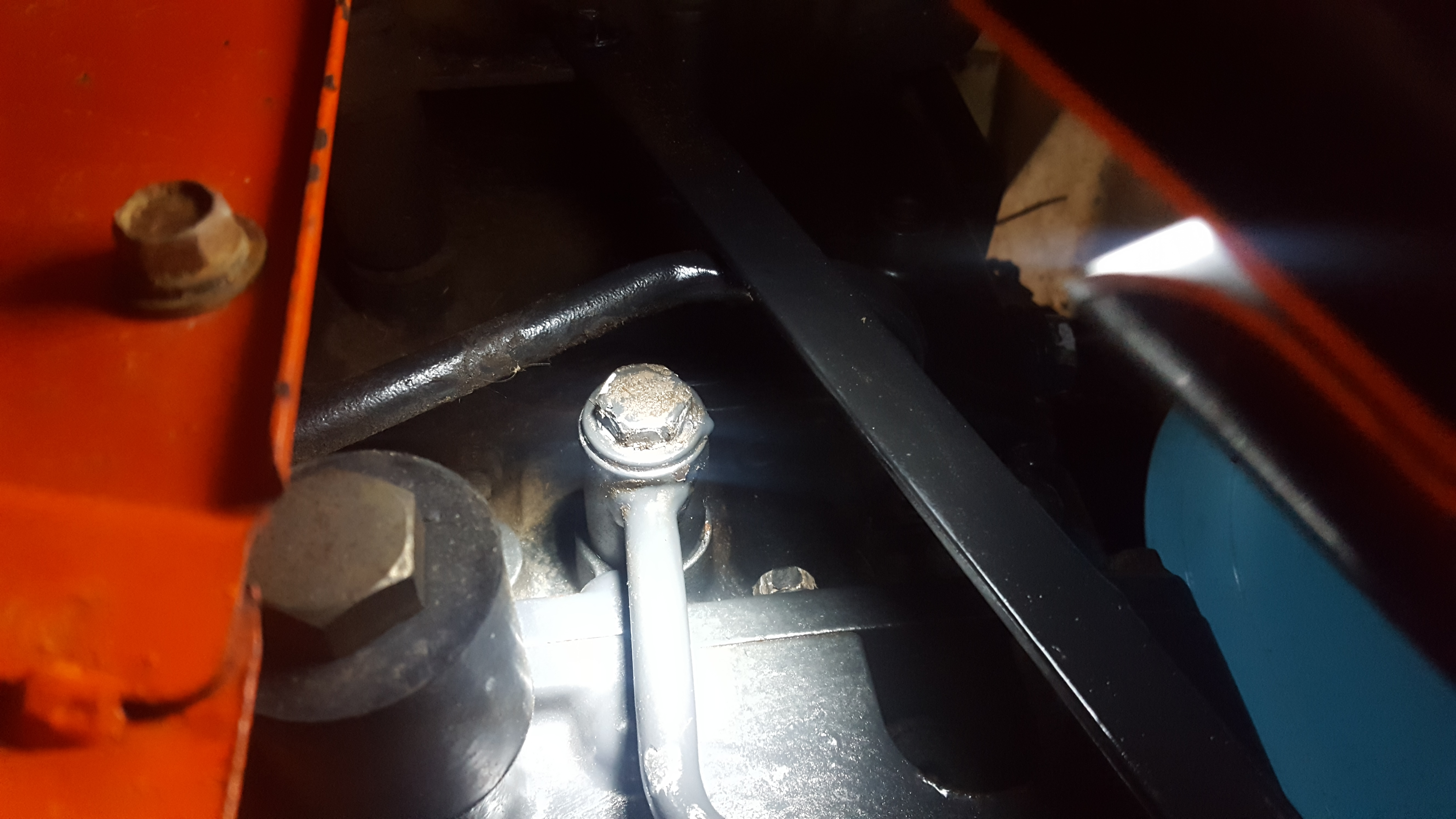

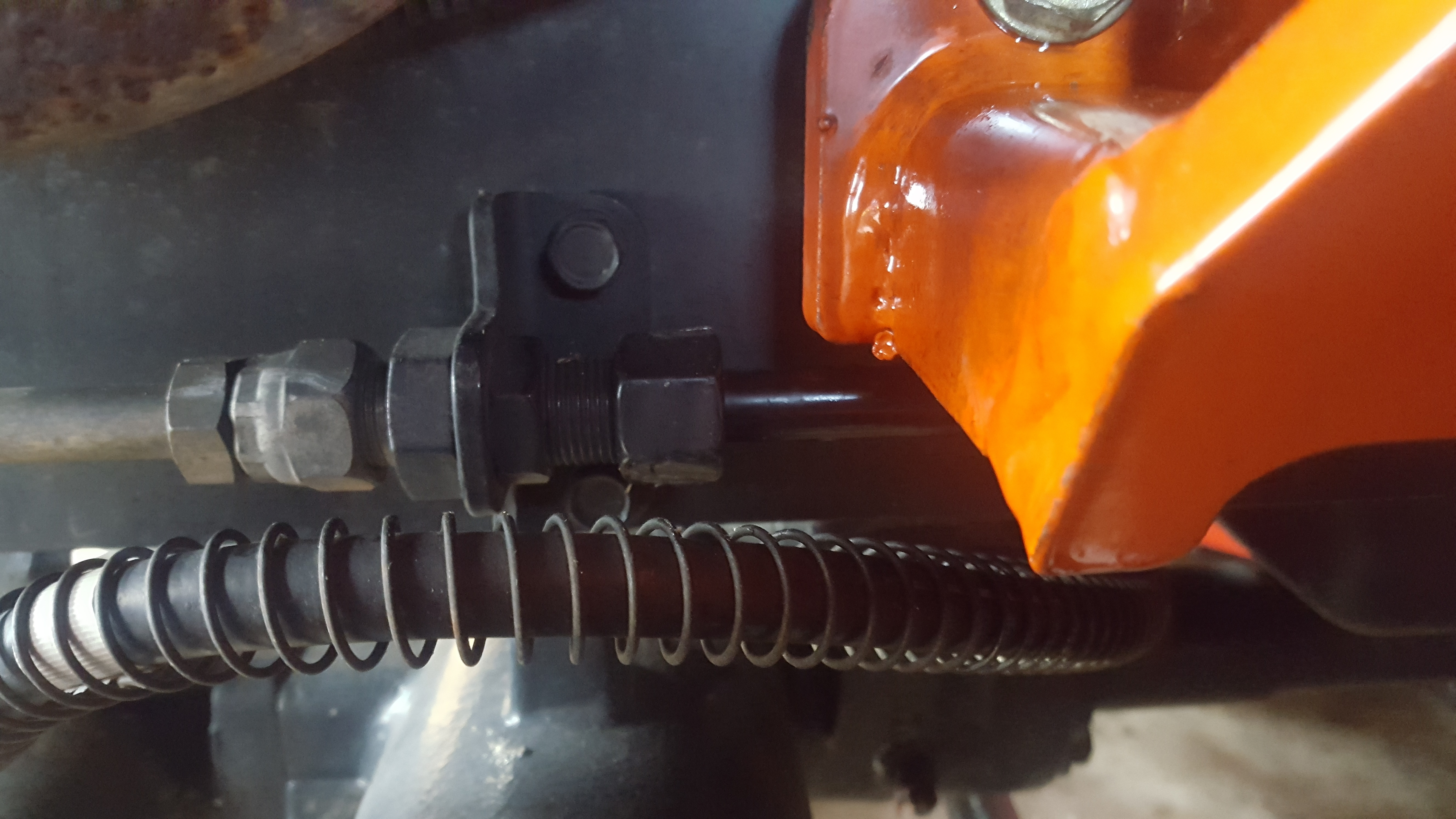

I'm having the same issue. I planned to take it off the line and have it brazed, but before I did, I figured I should ask someone that did it before, so I know what to expect....can I expect oil to come shooting out when I take it off? Should I worry about damaging o-rings? When I put my socket on it, it was very hard to turn, so I stopped trying. I'm going to post 2 pics, one of where it is attached to the transmission, and one where it connects to the line that comes from the oil cooler.
Is there anything I should be afraid of here? I lined up a local welder to bring the line to, he claims it should be a straight forward fix.
Any guidance would be appreciated here!

My fix has been very successful. I don’t recall how hard it was to remove. If I recall correctly I plugged the holes so I had very minor oil loss. There isn’t pressure in the line when the tractor is off and minimal when it is running.
