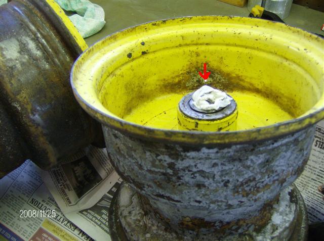

Just do some checking first! Some brands of "flat-stop" will eat rims, not sure about "Slime". Don't know what brand my JD 420 had in the front tires, but it eat a hole through the rim:
