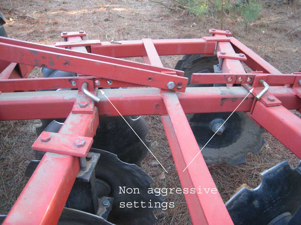

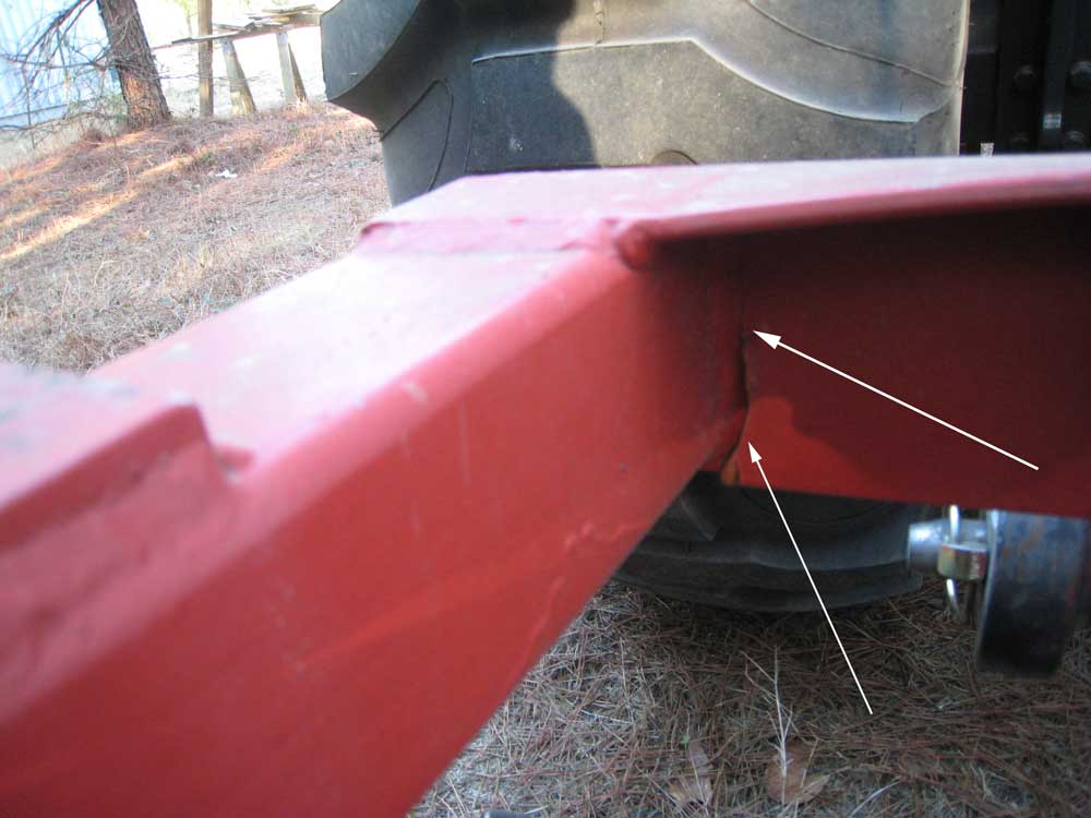

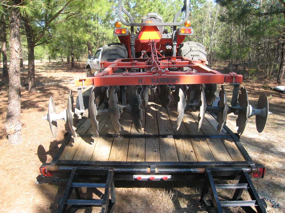

Frame on my Tuffline HD disc broke today. I went out this afternoon for a light day of disking. I hooked up my disc and pulled it up on a my trailer to take a picture. I did not notice anything abnormal but even with the disc all the way up it scapes on the ground when I put it on the trailer or take it off. I started disking with the disc level and at 70% deep cut. Later I backed off the rear disc to the flatest angle and from to about 20% of its adjustment. I was going to take some disking pictures but later when I unhooked my new TUFFLINE I realized that the frame was broken at both corners! When I looked at the picture before I started disking while on trailer I magnified the picture and I could see that the frame was already bending.
I am very careful with my equiptment but I have already had t have my QA modified.................and now this ARRRRRRRRRRG.

looks like it broke backing up?
That can be fixed with some jacking, not easy but can be done
/ TuffLine not so Tuff!
If I broke it while backing off the trailer would not the frame be bent in the othe direction?? I am dislexic so sometimes I see things backwards
/ TuffLine not so Tuff! #4
It looks like the 3 point hitch points at pushed towards the disc area and not pulled away, that why I would say damage done backing up
I good welder/fabricator and metal man will be able to fix that, the cost may be high because there is lots of labor and metal bending involved

When a 3-point disc is in the RAISED position, the weight of the disc would have the lower link mounts in compression (pushing forward) (And tension on the upper link mounting point) I'd think that's when and how the bending took place. From my experience, probably 90% of the frame damage to a mounted disc is the result of even the slightest hints of turning while the disc blades are in the ground. That puts tremendous stress on the frame.
That didn't "just happen". There was probably some cracking taking place for a while and it just finally broke out completely. It would have taken quite a shot to break that all at once.
There is an example of why there aren't a lot of GOOD older used 3-point disc's on the market. They take a thrashing even in routine and carefull use.

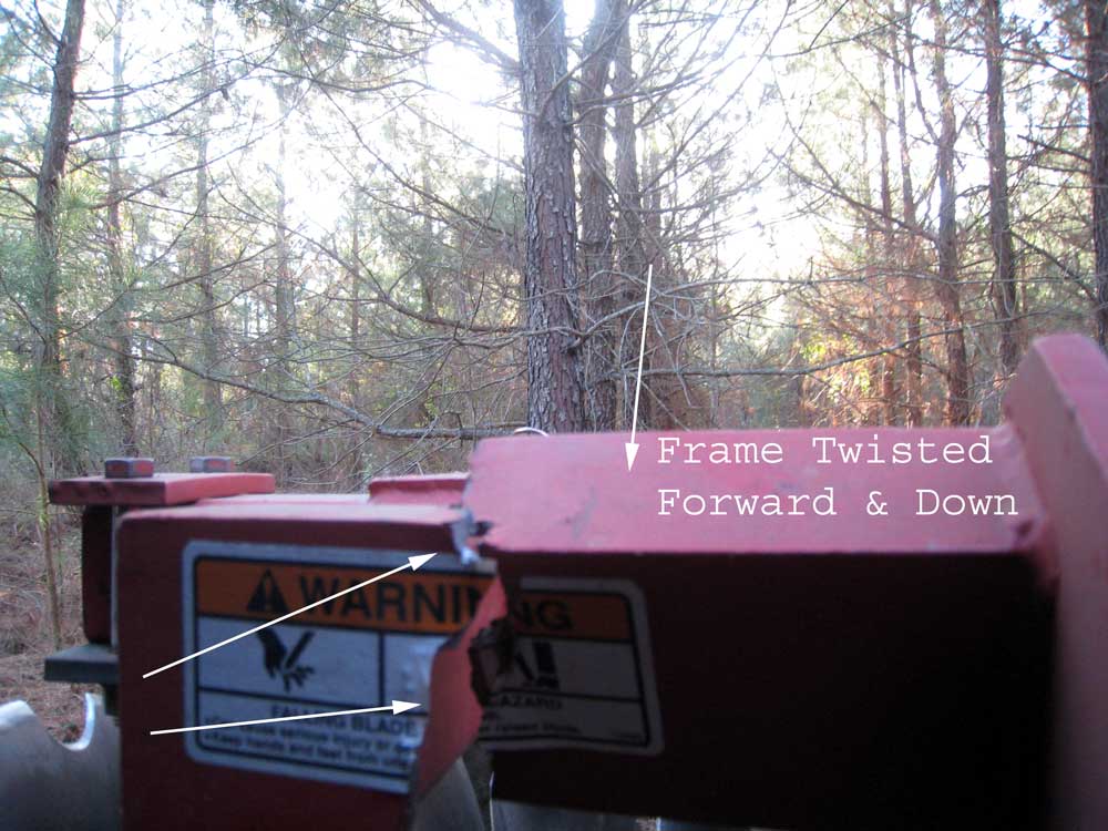

I agree with the guys above, looks like torsional damage for sure, repetative twisting of the frame. That could only happen over a long period of time, not instantly... How old is that disc?

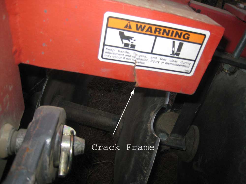

If you look close at some of the cracks you can see rust on part of the crack and shiny new crack edges on other parts of the same crack...so I agree this didn't ALL happen at once..:cool:

Bummer. If it was me, I'd take the link pin brackets off, cut the angle out (looks to be 2x2), replace it with tube and then weld the brackets back on. How are your welding/cutting skills?

I'd say that there is about a 99% chance that is the root cause. The 2x2 angle is not strong. Cut it out and replace with thick wall square tube or even 2x3 tube. Don't forget to gusset the areas too.

The problem isn't how he used/transported it, the problem is that 2x2 (or 3x3 if that's what it is - looks like 2x2 though) angle won't do what they asked it to do. Can you imagine the torque? They knew they had a flex problem as that's why the flatbar is triangled in on the backside of the lower link brackets. Boxing it in would be fine if it hadn't already stretched, distorted and torn, but IMO it's a major waste of time straightening any of that. 15 minutes with a torch, 10 minutes with a grinder, 10 minutes cutting the tube, and 20 minutes to weld it up. Done.
