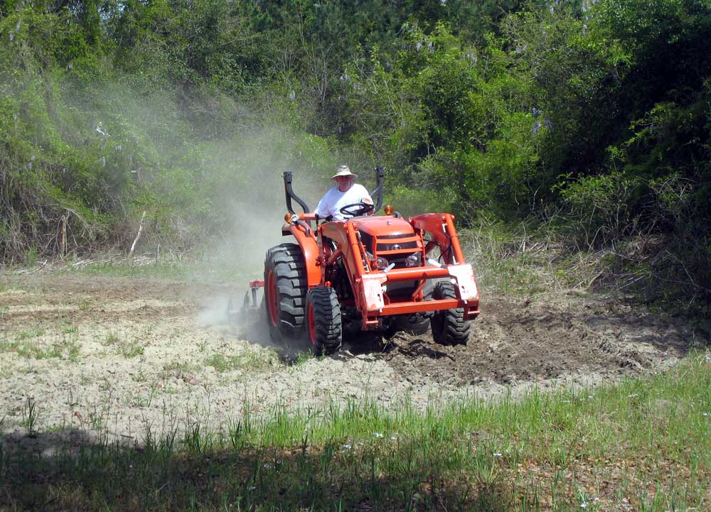

I still have not heard from tufline. What an outfit! A friend of mine volunteered to repair the disc. He has been a welder by trade and felt the front of the frame was poorly designed or maybe a batch of poor quality steel. Anyway he straightened it out and rewelded the frame back to original. He then added a steel plate on the front and then welded some channel on the back of the frame at an angle. He said that he fixed it the old fashioned way......he stick welded it. I know nothing about welding but he said he thought stick was the strongest way to repair it. I gave it a pretty good workout this last week and sofar no cracks. TufLineRepair.jpg
