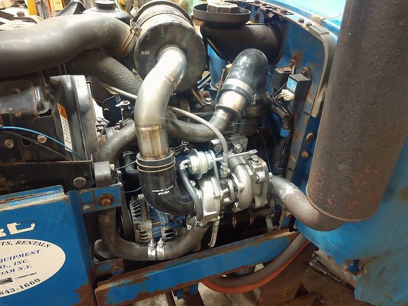

After the last snowstorm, it was very apparent my 1620 could use some more *** for blowing large drifts. For a total of $300, it's now turbocharged!
Disclaimer, diesel performance is what I do for a living. I fully understand the potential risks and methods for minimizing them.
Please don't judge the charge pipe, I needed something quick and easy as this whole job was done in under 7 hours. I'll eventually build a nice pipe out of 1" ss tubing and use a proper reducer to step up to intake manifold size. I'll post more pics tomorrow.

Finally got a chance today to mount a temporary boost gauge, tweak the fuel screw, and go out and play. Backed the fuel screw out just shy of two turns and HOLY CRAP! This is how it should've been from the factory. I can actually drive up my driveway in high range at full speed. Before, I'd have to drive in medium range or else it would stall out.
Went across the road to the neighbors place for a good test with the blower. His driveway had about 10" of snow on it and is even steeper than mine. Normally I'd have to creep as slow as possible in low range with a full blower width and feather speed as needed to keep it above 2krpm. With the turbo, I went up at full speed in low range and it stayed above 2500rpm.
I have an egt probe on the way to read with the multimeter, but considering the exhaust is cleaner at full load than when it was stock, I know it's not anywhere dangerous.
My only complaint is that I can't hear any whistle :laughing:. Otherwise, I don't know why I waited so long to do it!
Here's a video doing the neighbors driveway New Holland 162 turbo - YouTube
Here's some pictures of building along the way:
Cute turbo sourced for $250 from ebay
What we started with
Adapter plate
Fits like a charm
Pulled the banjo bolt that fed the cylinder head with oil, drilled head through, and welded a -4an bung on the end
Welded up a -6an drain flange
Used a sharp punch to pierce the oil pan instead of drilling a hole and making shavings, tig'ed on a 6an male.

So, as to your 'diesel performance' backround, would you have a suggestion what turbo I might look into for my tractor? Id like to attain peak boost/power at 2800-3000 rpm, out of a 3 cyl 1.3L diesel motor.
   / Turbo NH 1620
Run the same turbo I'm using. It's originally spec'ed out for a yanmar 1.4L 3 cylinder and works just perfectly on my 1.3L. You won't be sorry you added the turbo :).
