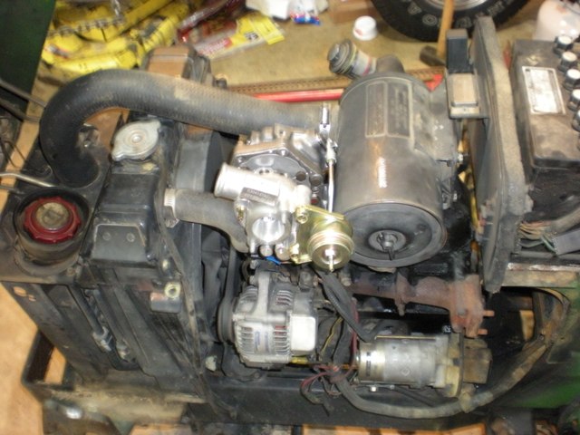

I got my turbo and I am in the process of getting the adapters made and assembling oil lines. I'll take some pictures as I get started and post them.
My question is does anyone see a problem with returning the turbo oil return line to the valve cover. The turbo will sit high enough for the line to be sloped down. This seems the most direct and easiest way to do the return line. Let me hear your thoughts on this.

As to the return line going back to the VC, it should not be a problem as long as the engine has the return capacity(internally) from the head to the oilpan. You are going to be adding alot of oil to the valvecover area and you want to make sure it can get back to the oilpan quickly or you could end up with the VC full of oil and nothing in the pan.

I figured since there is an oil fill port in the cover it can drain oil quickly enough for the turbo. This turbo does have a restrictor in the oil inlet so volume should be less than one without. I figured as long as I kept the turbo higher than where the return goes in I would be ok. There is not much room in the front gear cover for a fitting unless I can put one in where the injector gear is as that seems the easiest access. The last option would be to drop the pan and put a fitting up high on the pan above the oil line. Since the engine uses a spacer between the block and the pan, the crank should not be an issue but I would have to verify that before I drill there.

I put a turbo from SPF on my RTV1100 and the oil returns to the spare dipstick hole on the exhaust side of the engine. Originally they used a fitting into the top of the oil pan, like you said, above the oil level.
That much oil in the valve cover will probably lead to problems eventually. Like you are running all that extra oil over the hottest part of your engine just to get it back to the oil pan and with the extra oil in the valve cover, leakage by the valves can be an issue.
Mine runs 5-7lbs boost and depending on the pump adjustment, can be very hard on fuel. Backed down to minimal adjustment it gives just the level of power I was looking for and good fuel economy as well.
Very easy to have excessive power, low fuel economy and no great benefit to productivity. Probably just break more stuff.

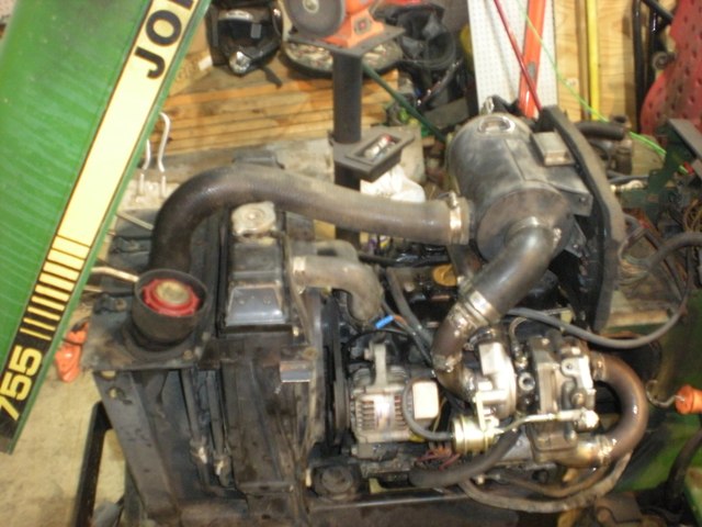

I am in the process of putting a turbo on my 755. After finding the turbo was too big to fit where the muffler was, I will be making a header and putting it above the engine. I am also thinking about putting the drainback in the valve cover. I have to pull it off to fix a leak, so I will take a look then.
I had to put the exhaust back on today to plow snow too. I blew up my truck last week, so I spent my days off buying a new one. I gave my pipe bender away when I moved a few years ago. I thought I wouldn't need it anymore. I bought a new one today. I will be tearing into mine next week.
I have a TD02 twin scroll. I will see how a twin scroll works on a three cylinder.

Hit some snags at the moment. I made that exhaust mounting an exact duplicate of the muffler. This puts my oil return wedged inbetween the valve cover and exhaust (still is not a problem as it will hookup). So I will have to raise that up.
Also I am trying to use the existing air filter and this is a problem as the compressor intake hose interferes with the turbo outlet. They block one another at the valve cover. I will have to see if I can flip the small top intake cover where the air intake is at. If I cannot flip it then I will have to see about another filter option that can filter the dust well enough.

why not put the air filter just ahead of the rad above the battery?
