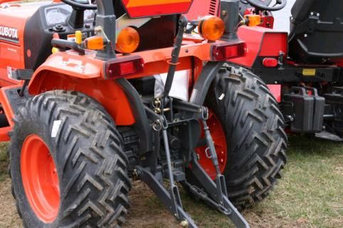

Here's an interesting looking tire. I heard the called "bar turfs".
They look great for snow, wet grass, and light mud but they may bugger up the lawn in a tight turn?
Anyone got them? could you comment?
