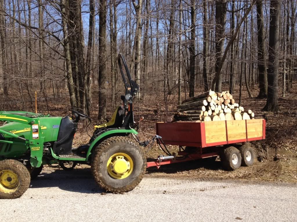

The most important thing is having 4WD on your compact tractor. Most can make a case for their current tire type. I have turf tires (R3s) on my compact and love them. Have used a 790 4WD and loader with R4's and it was nice too.
Consider how you will be using it as the others have said.
Dan where did you get that awesome dumpcart?
