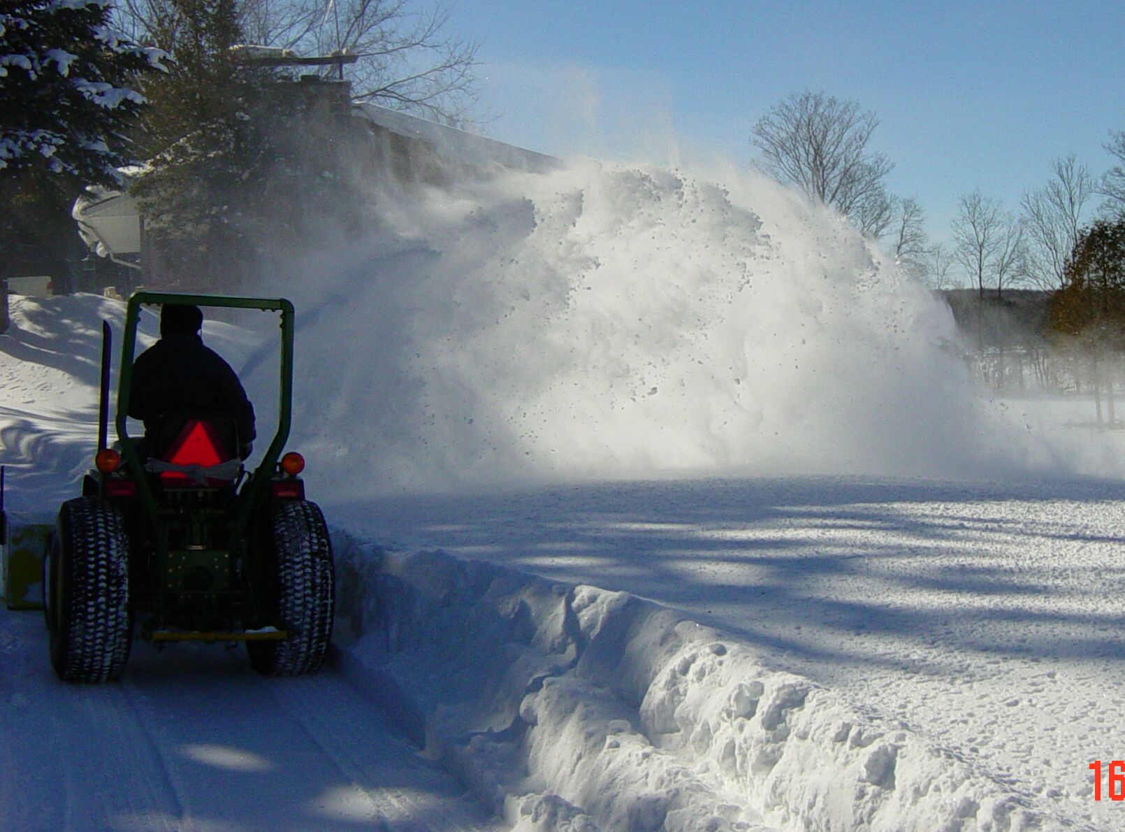

For mowing and snow removal, turfs are the way to go. More contact surface with turfs. I have them on my B2650 and live in the snow belt in NE Ohio and the turfs work great.
My turf tires work pretty good in the snow. I added chains and some weight in the rear and never have any problem plowing snow.

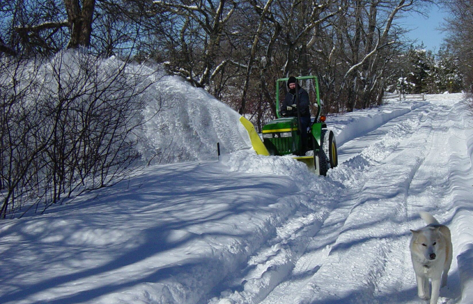

This was years ago. JD 770, front blower.
Never had any bad issues with the Turfs, except the Odd time, I kind of drove into a Dip, and couldn't back out. Rear 3PH weight would probably have solved that.
In certain slushy conditions it's also nice not to have more aggressive tire tread marks making for a washboard when it freezes.
