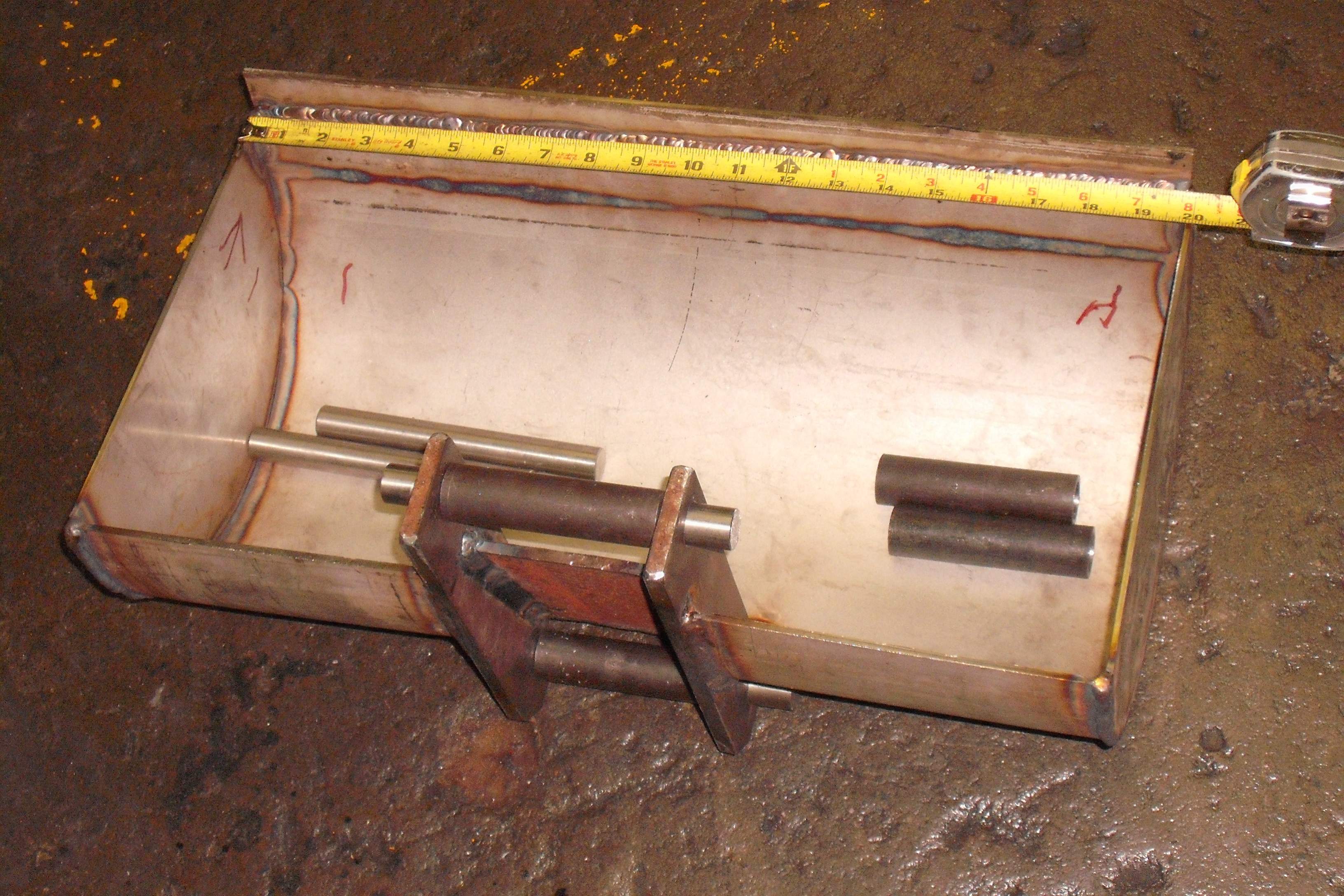

Bob I have this Project going but have not decided how long to make the boom. Any Ideas. Extendable ????
Stray is that designed to be mounted on the minihoe? It looks good, perhaps more than I had in mind. I was hoping that someone had done something, and it looks like you have. How about some more dimensions. Does is directly bolt to the minihoe?
As for length of the boom, I would tend to match the minihoe.
