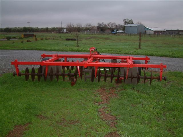

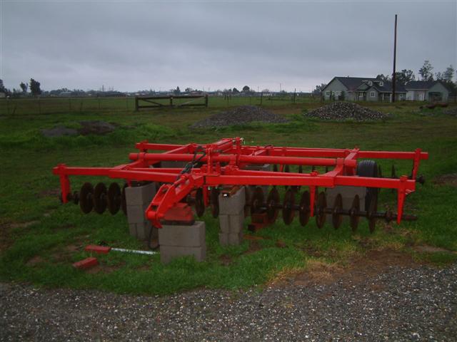

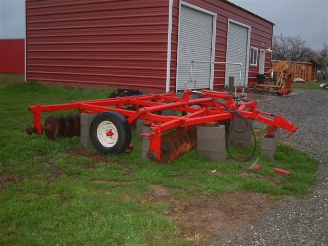

Attachments need not be too expensive if you shop around. For example I paid $600 for this 13-ft tandem wheel disc (you'll need one of these for sure).
I removed some of the outer pans so my 54 hp Mahindra 5525 can tow it. A 100 hp tractor should handle it without a problem.
