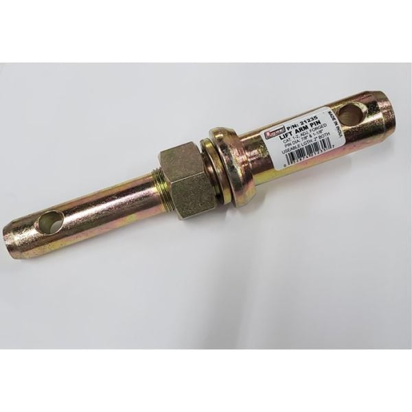

So I have a B2601 tractor, I need a box blade for it. They are frikn $$$$ for a 5 ft blade, so I have a 7ft or 8ft almost new box blade. I have tried to sell it but no luck, most people don't have a big enough tractor for it.
It is paid for, so I am thinking about cutting it down and rebuilding the hitch to match a cat 1 using this chart

I might try a 1/2 link pin, with the cat 1 facing inwards, and the cat 2 facing out.
You might have to check the thread diameter on your existing pins. Perhaps there are different sizes, or they could be shimmed.
Measure your hitch arms to see if you can swing them out wide enough.

You can always shrink a hole by getting some fairly thick washers of the right ID and welding one (or two) on each side of the hole. I've found large washers to be surprisingly cheap on Amazon.

If you have a cat 2 hole and need to use a cat 1 pin to go thru your lower lift arm or top link Just go to Tractor Supply and buy a bushing. Cut it in half so there is bushing on both sides of the lift arm and in the box blade holes.
My hydraulic top link has a cat 1 hole and my JL501 winch has cat 2 holes. I split a bushing and all is good.
