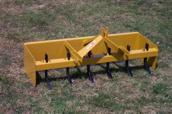

/ Box Blade or bust? #6
Box Blade or bust? Which would be the better attachment for road repair?
