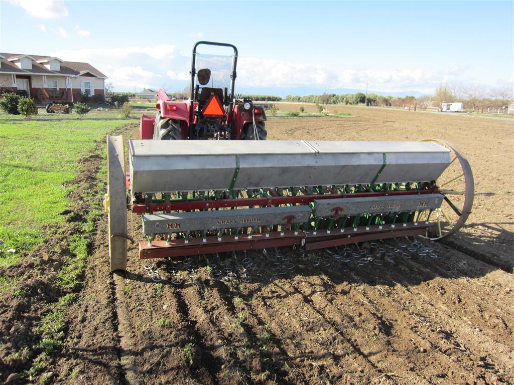

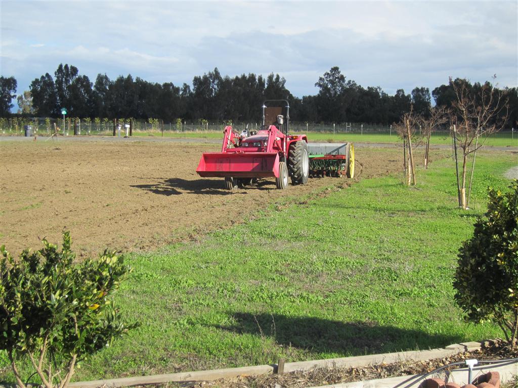

   / Turning Plow or Tiller #10

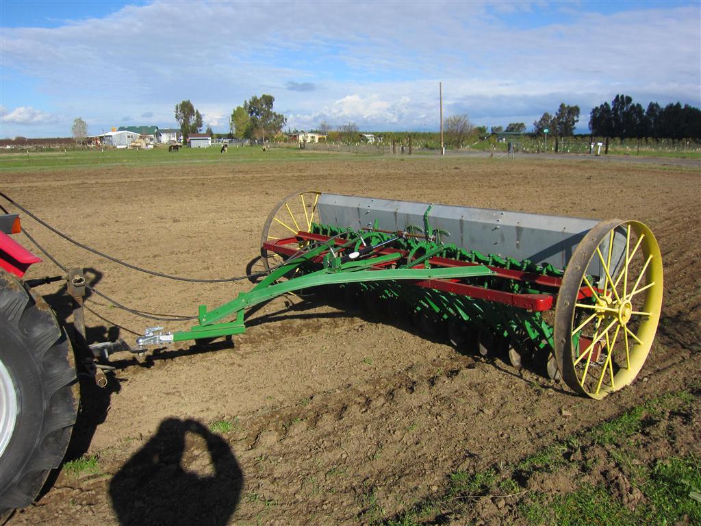

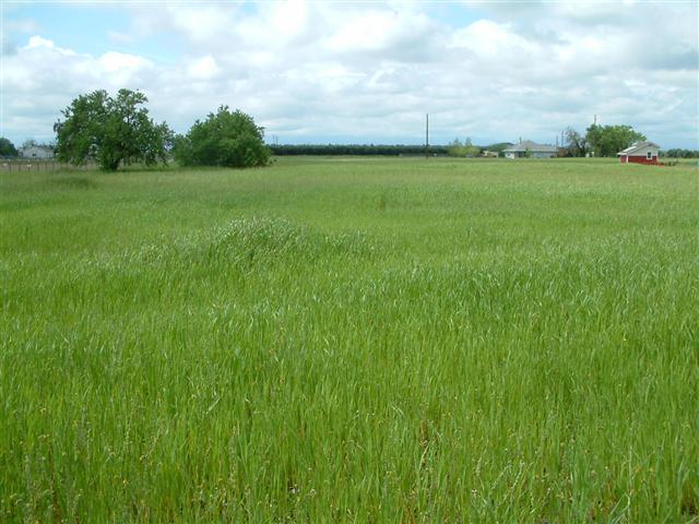

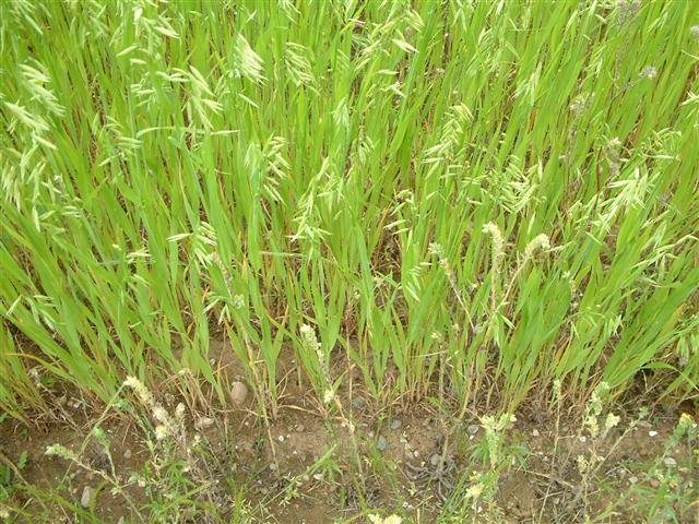

I have a small field to plant this fall for a food plot, probably oats and wheat. I have a turning plow and disc. The field has lots of rocks and I would prefer not to bring them to the top with a turning plow. I can borrow a 3 pt hitch tiller. The field is only about 1/3 acre so the tiller will do the job. I've never owned a tiller so my question is......will the tiller bring less rocks to the surface than the turning plow?
Forget the tiller. My 10 acres is gravely loam with occasional potato-size rocks. I run my 7-ft wide offset disc over the hayfield with at attached tire drag (a piece of chain link fence with tires mounted on rims chained to the fence and the entire drag chained to the back of the disc). This gives me a smooth planting surface for my 10-ft wide grain drill (a restored Minneapolis Moline P3-6, 20 drops, 6" row spacing). Here are some photos of my stand of Kanota oats.
Kanota oats-2.JPGKanota oats-1.JPGM5525  drill-1.JPGM5525 drill -2.JPGM5525 drill---3.JPG
Good luck.
