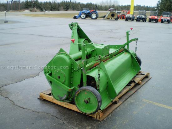

I have 8 acres or so of rocky, glacial till soil in Maine that was heavily overgrown with red osier dogwood, thornapple, and buckthorn. To reclaim it I bought a 1964 Howard k80 Rotavator, a very heavy old beast. It did a great job chewing up the roots of the brush, but the big rocks kept breaking tines. I replaced the top link with a heavy-duty weighted shock-cord made from a doubled-up lifting sling. The cord absorbs enough energy that I no longer break tines. The big tiller just spits out any rocks smaller than a basketball and when it starts to bounce on larger rocks I just pick up enough to clear and let down again and keep going. I still have to retighten some of the tines (using grade 8 bolts and a 3 foot pipe) every half-day, or sooner in heavy rocks. Of course the tractor takes a pounding similar to what a backhoe would give it, so I put a heavy subframe under it to keep it together. So far, so good.

How about some pictures of the 1964 Howard K80 ROTAVATOR?

Sorry, I have no way to do a digital image at the moment, but here is a pic from the internet of a Howard k80. Mine is just like this, but without the depth wheels. I removed them to save weight and I control depth with the 3 point hitch. Howardk80.jpg
