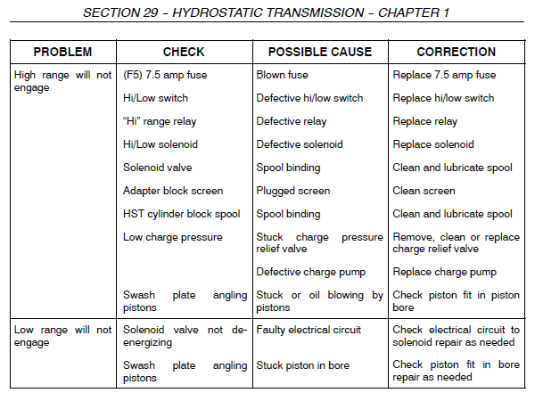

My turtle/rabbit toggle switch and button control on the loader level is not working. Low and High gear lever works fine. Help.
   / Turtle Rabbit switch TC 35DA #2
This is from the TC repair manual.

The TC is basically the same as my Case. Mine would sometimes not work and what I found was the toggle switch on the fender would sometimes stick, thus not allowing the buttons on the loader handle to function either. I was looking at TC35 the other day for a friend to buy and it had the same issue.

Did you replace the hi/low switch?
   / Turtle Rabbit switch TC 35DA #5
I have not. I did blow around the rocker switch with compressed air and it has not given me any trouble since. Doesn't look like it would be to hard though.
