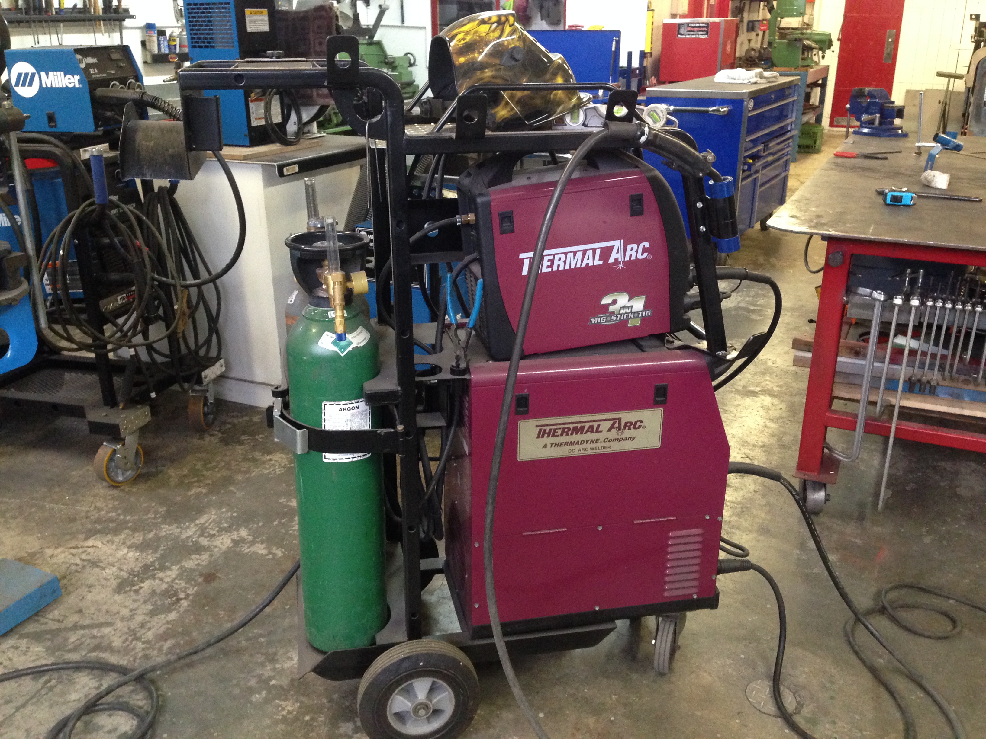

Other options would be a 25' spool gun or a $1000 30' pull gun.
   / tweco 181i welder #9
Not a Push Pull. Just the high speed Pull. No sync. Gun pulls faster than the feed pushes so there's a little spin out on the pull end but it works ok.
