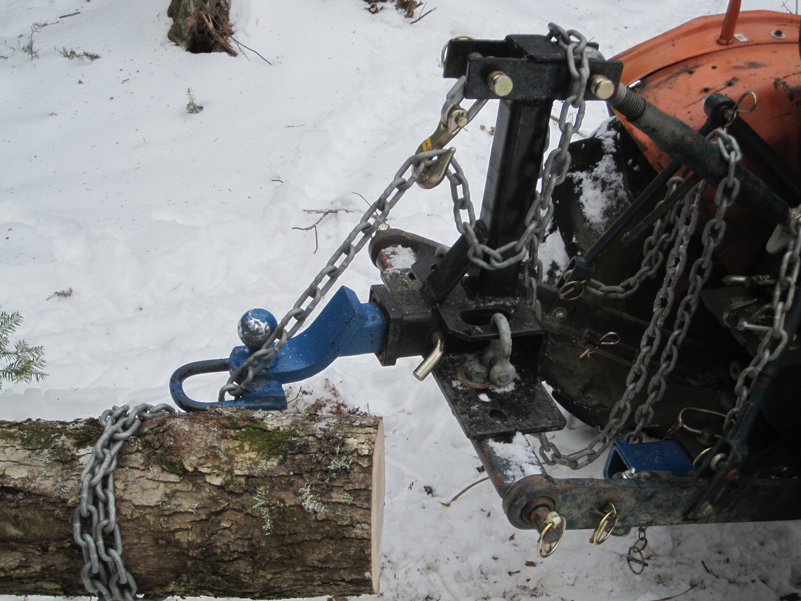

   / twisting drawbar on 3 point hitch #9
Here is what I made to use on my Kuboa B7100 & Ford 8N. Works great as a trailer hitch, log skidder, & I have made gardening implements that use the same hook-up.004.JPG
