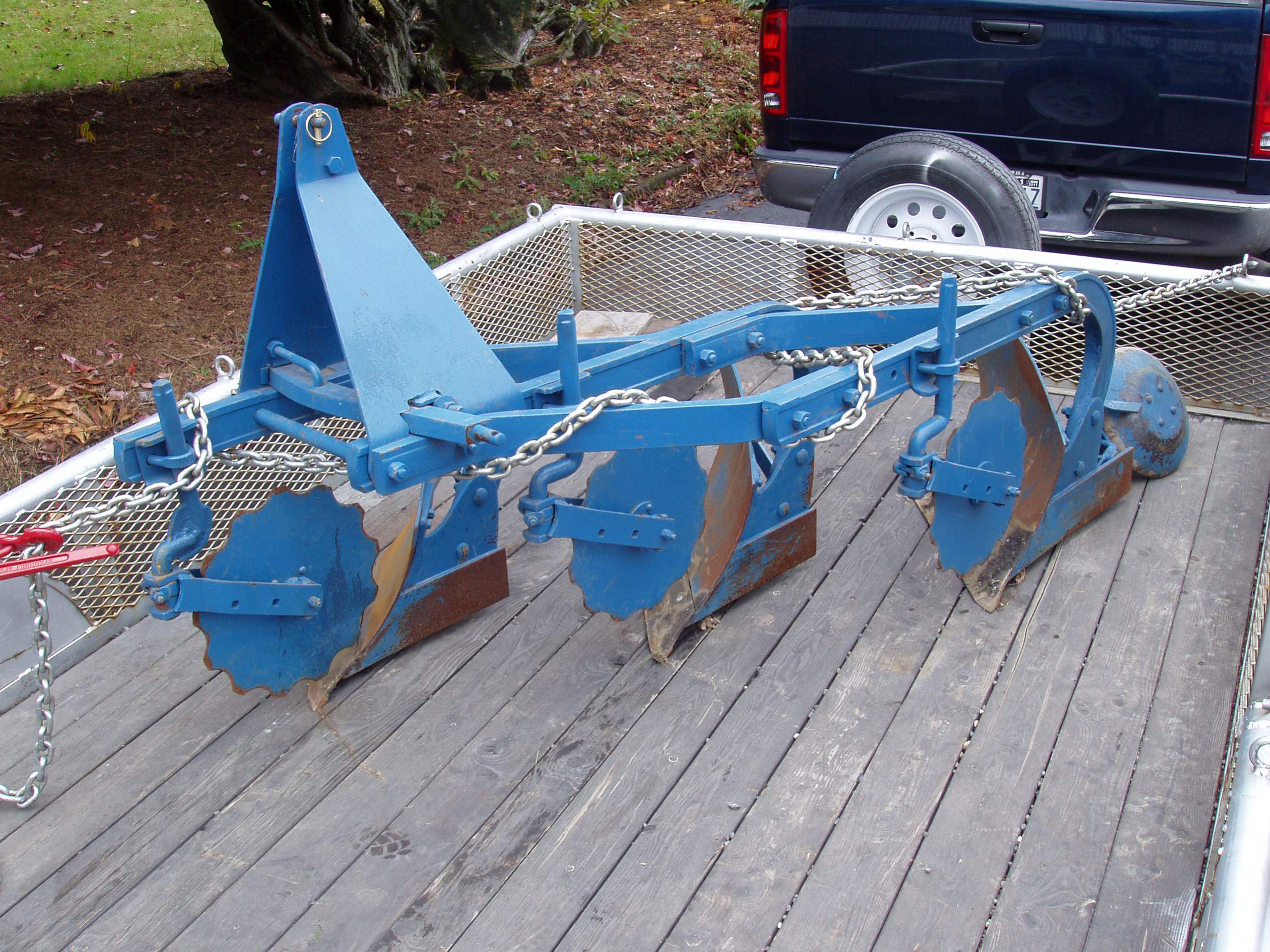

purchased a ford 640, it came w/ a two bottom plow.
I tried to attach it today to the 3 point hitch. WHen i backed up to it the cutter disc in the front of the plow bumps into the pto area of the tractor and the lifter arms aren't long enough to attach it. As you can probably can tell I am new to all this, any help would be awesome, thanks.

Can you attach pics of the tractor and plow showing your issues with the hookup to the 3pt. Was this plow ever attached to this tractor prior to your purchase. If not, it may need some "setup adjustments" to hookup. Are you able to remove the front "coulter" if so would this allow the hookup.

if the front "coulter" is that disk that hits the pto, than yes i think i can remove that.
/ two bottom prow #5
Here is a photo of my plow the day I brought it home. As you can see I have a three bottom with coulters and mine are adjustable/removable. They are useful in cutting the trash, some folks use them and some remove them. Hope this helps.

It may simply be that the lift arms aren't long enough to allow the plow to mount without the front coulter hitting.. mine is close on my L3400 Kubota too.
If you're plowing already broken ground, the coulter can be removed, but if you're working with unbroken sod they are really nice to have.
The seller might have included the plow because it was no good to him either, a lot of stuff goes like that.

its unbroken bround, can i get longer lift arms?
/ two bottom prow #10
You should be able to get generic ones.. or cut yours and get a short section welded in. I'd try to reposition the coulter first if you can, it's not that easy sometimes though. Is there any way to adjust the lift pins further forward on the plow?

got the plow on, the coulter need to swing in, it was out front and it was just rusted up.
I'm an idiot!!!!!!!! lol ty for your help.
