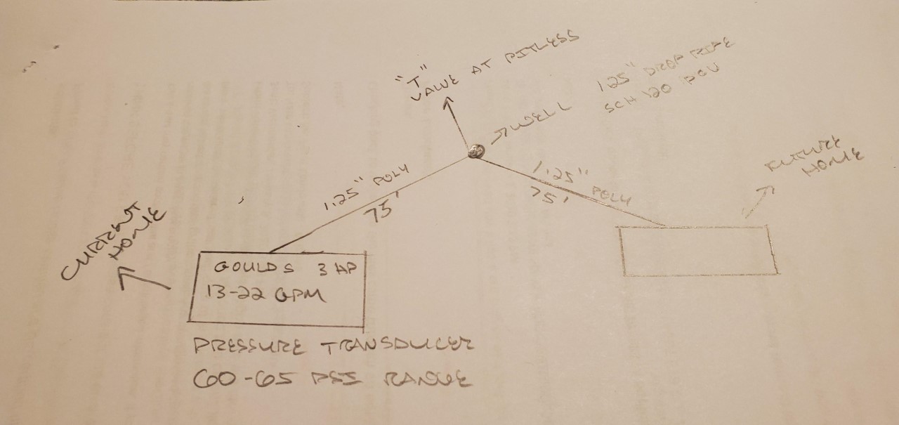

Well has enough production but wondering about design. Currently a well is supplying a home and there is a 1.25 inch water line with a VFD (variable frequency drive) controller in the garage. Once you open a water line in the home, the pressure drops, then the VFD controller registers the drop and it kicks the well pump on. It keeps a steady 60-62psi water pressure the entire time the faucet is on.
My future 2nd home will tap into the current well with a "T" at the pitless adapter with another 1.25 inch line to the new home. Since the VFD is in the other garage of the current home. Will it still work properly at the 2nd home?
Since the pressure drop will be on the other end of the line, will the VFD still be able to function properly?

It depends where the check valve is. If their is a check valve between the VFD pressure sensor and the pitless the second home wouldn’t “trip” the VFD sensor. But without a check valve in that section the plan will work fine.
I have a similar setup and found it was easier to run the second home from the first house if that makes sense. The well is in the middle of the two homes but it was still “easier” to go into the one house and then back over to the second home. My system has one line going back out for irrigation and the yard. Then the water is treated for domestic use. After that one line goes to house 1 and one line goes to house 2. All 3 “zones” can be isolated from each other without issue.

As others have mentioned with the 1 1/4 to the first house then a feed thru 1 1/4 will be a bit better then teeing off.
If you tee off the behavior will depend on where your pressure switch is located with it in the first house a high flow in the second
could result in a low pressure swing in the first as the water leaves your pressure tank to go to the second.
A second pressure tank in the second hose will help.
This is a situation were a pump house and pressure tank and controller at the well is benifical especially using a tee configuration.

It depends on how large your pump is, what kind of VFD you have, and where the pressure transducer is located. You could have a 5 GPM pump, or a 25 GPM pump. You will need at least 10 GPM to supply two houses at the same time. If the VFD has a pressure transducer and there is no check valve above ground it might work. If the VFD has a pressure switch it probably won't. But either could pulse the pressure when the other house is using water. The water will be coming and going from the line to your house as the pressure goes up and down and the tank fills and drains.
Goulds 3HP VFD with pressure transducer
13-22 GPM Pump Output
The controller and setup are currently in the garage of the current home.
There are NO check-valves in the line AFTER the pitless adapter. There are 3 check-valves in the 1.25" drop pipe in the well.
See sketch I made.
