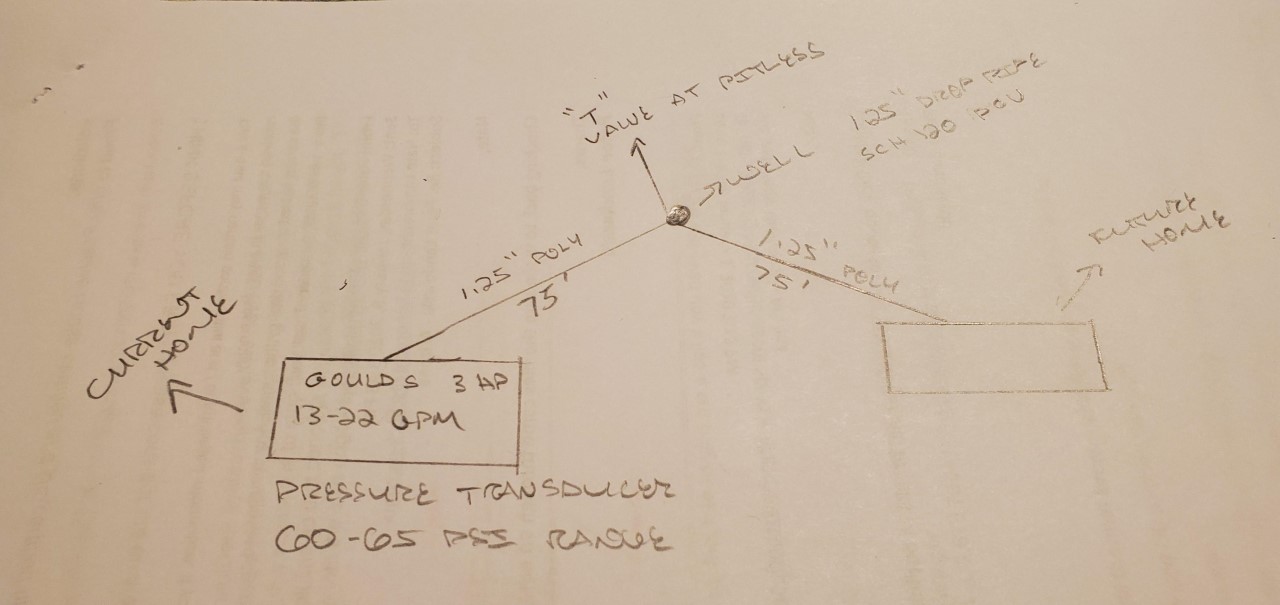

Both homes are on the same lot and they will NOT be split up. One will be a guest house and the other the main house. The well can supply the water for 2 homes. Static water is 200 feet and depth is 500 and the well puts out over 20gpm at 300 feet.
   / Two Homes Off of One Well Pump #13
Goulds 3HP VFD with pressure transducer
13-22 GPM Pump Output
The controller and setup are currently in the garage of the current home.
There are NO check-valves in the line AFTER the pitless adapter. There are 3 check-valves in the 1.25" drop pipe in the well.
See sketch I made.
The Goulds Aquavar should have a pressure transducer, not the switch. So it might work. However, like I said, when that unit is in sleep mode the water will be coming from the pressure tank, and when the pump is on it will be coming from the pump. That will probably cause the pressure to pulse, which wouldn't happen if you tee the second house after the pressure tank and transducer.

As long as the check valve is before the second house junction it will work. The pressure tank & switch installation location will see it as one system which it is.
A larger bladder tank would help on cycling.
   / Two Homes Off of One Well Pump #15
According to your diagram you already have a tee at the well and are doing exactly what you are asking. But, now you want to add a third. So if you have no issues now, then it should work fine. The benefit to tapping into the current house is that it looks like in your drawing the new house is past the old house so no point in running all that extra pipe if you can go right to the existing house. Also, if it is an occasional use guest house, you might want to tap into the softened water so you don't need 2 sofeners. That is where you will save the money. But, you need to look at your softener throughput.
When I did my barn, I ran a dirty well water line and a clean softened line. I would suggest you do the same so you can run the hose out there if ever needed.
   / Two Homes Off of One Well Pump #16
Actually having three check valves down the well is a problem. Each check will isolate a part of the line that will crash into another check valve isolated part of the line anytime the pump starts or stops. Most people think if one check valve is good, two or more would be better. That is not the case. Low flow from VFD's cause problems with check valves already. But the soft start feature may keep you from seeing the water hammer that happens with too many check valves. Having only one check valve at the bottom of the drop pipe is best.
You shouldn't need a larger tank if the VFD is doing its job. And it is not like a regular pressure tank/pressure switch system, so pulsing can be an issue, especially when teeing off prior to the pressure transducer.
